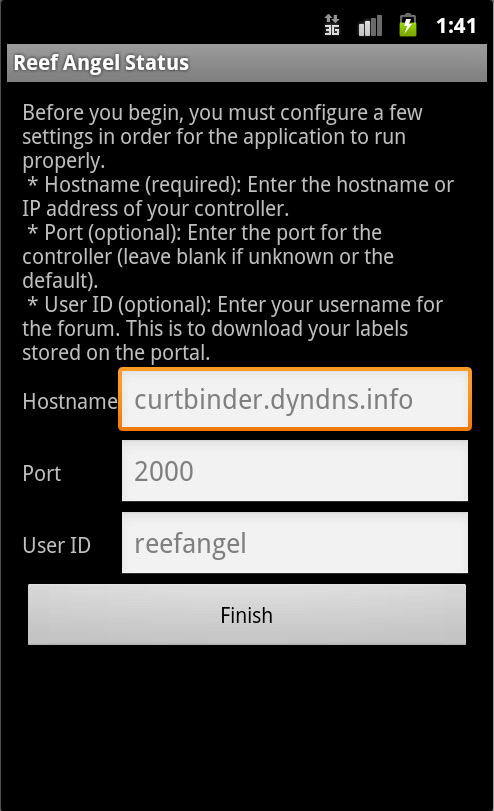

Just so everybody knows, there is now a "welcome screen" for the app. It only appears for new installs. It will not appear for anybody who currently has it installed. The screen prompts for you IP / URL to your controller, the Port for the controller and your username for the portal. It currently does NOT allow you to select the reefangel.com option from the welcome screen. BUT you can change it later under the settings.
The URL is the only field that IS required. This can be an IP or a URL (just like always). There is an example of my test controller filled in. The only "catch" is that this screen will not allow you to use that URL (you could always change it in the settings but why would you??).
So here's a screenshot of the welcome screen.
Welcome Screen
Welcome Screen
Just thought I'd share for people so you would know what all is going on now. :)

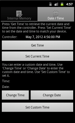

Working on a Date & Time screen....
https://plus.google.com/u/0/11649030441 ... Gw7RvNyUcH
Here's the screenshot of the Date & Time screen. It's almost completed. I've just got to get some translations done and then it should be ready for release.
Date and Time screen

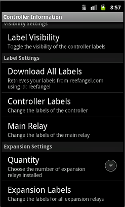

I've been busy over the last 2 days. I've almost got a "key" feature that's been requested for a while.....expansion relay support. It's not just for 1 relay, it's for up to all 8 relays. There's a few small details left to be ironed out, but it's working. I've tested it with 1 expansion box and am planning on testing with 3 boxes. The downside is currently it's one really long screen, so you must scroll to view all of your relays. Don't sweat it though. After I get it released, I will be working on a better way (did somebody say swipe left or right) to view the information.
Here's a screenshot of the settings:
Expansion Relay Settings
Can I ask for feature :) on next revision?
Maybe use EM and REM from XML to determine the expansion modules available?
rimai wrote:Can I ask for feature :) on next revision?
So we could have a "Download settings from portal?" option that would download the expansion quantity?
I already pull down all the labels (expansion included) when the user requests the labels. :)
Yes, this would also work for other expansion too.
They could be automatically displayed on main window or additional window when you query the controller or query the reefangel.com site.
if (EM & 1<<0) then it would enable the PWM window or display the %s on main window.
if (EM & 1<<1) then it would enable the RF window or display the mode, speed and duration on main window
if (EM & 1<<2) then it would enable the Aqua Illumination window or display the Aqua Illumination %.
if (EM & 1<<3) then it would display the salinity on main window
if (EM & 1<<4) then it would display ORP on main window
if (REM & 1<<0) then enable expansion relay box 1 window and so forth for additional relay boxes.
I think it would be pretty cool :)

I like the idea of it. Currently that could only work for PWM, Salinity and Expansion Relays.
I'd have to add the ORP to the display (on list of things to do).
The RF window doesn't exist yet and the displaying of the values doesn't exist yet either.
The AI window doesn't exist yet and displaying of the values doesn't exist yet either.
This suggestion does give me some ideas though. I'll see what I can work up. :)
FYI....I've completed the expansion relay support. There's a few other small quirks that I'm going to look into and I'm awaiting on some translations too. Be on the lookout for a release soon.
Oh, and I just tested out controlling and displaying 3 expansion relays....works like a charm with toggling them on/off/auto. :)
