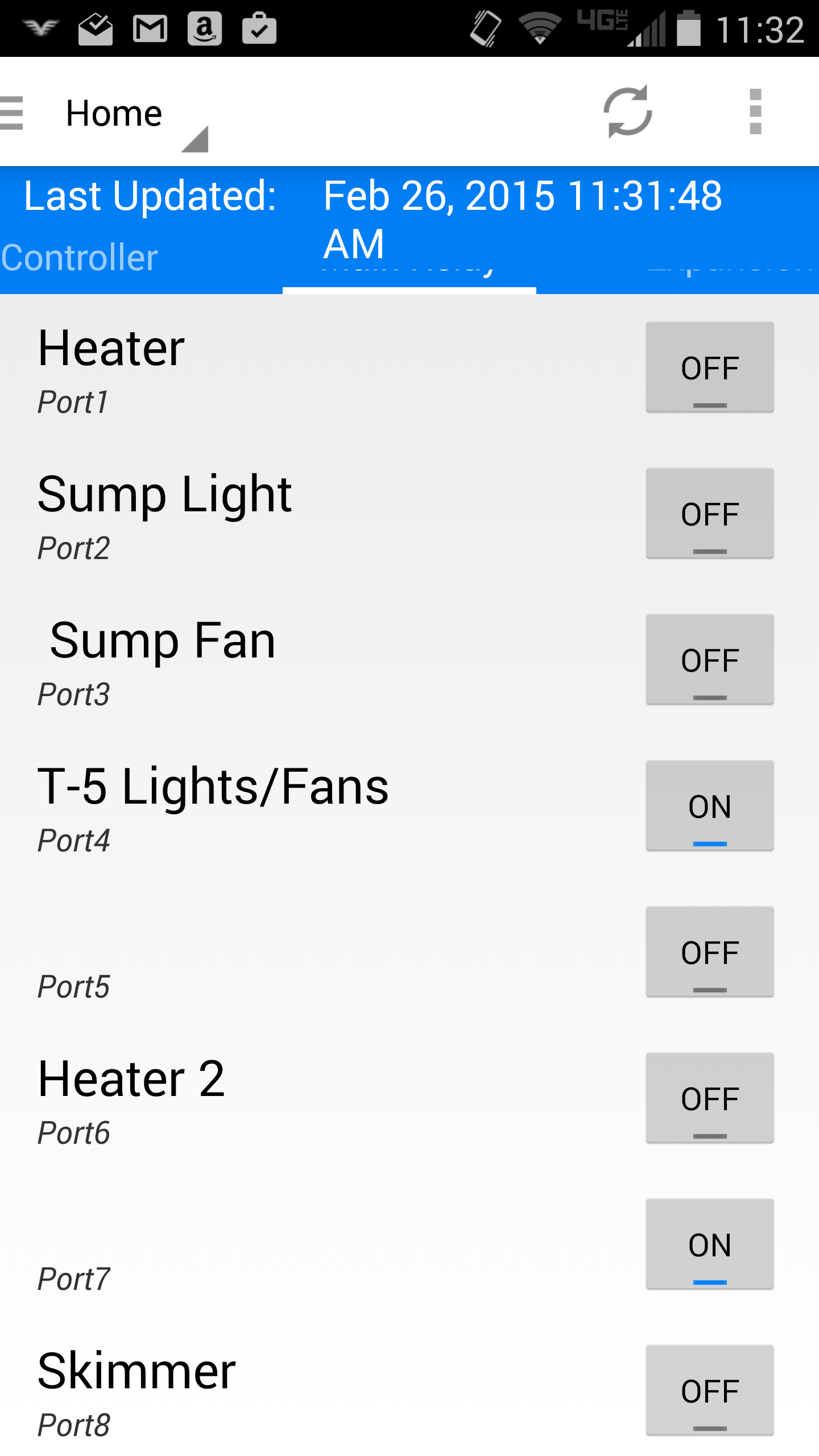

Posted: Thu Feb 26, 2015 12:34 pm
by pandimus
The screen Label gets covered up be date and notifications
Posted: Thu Feb 26, 2015 12:37 pm

yeah. i knew it did that with the errors but had not seen it on the normal dates. I will look into either making the text smaller or adding extra spacing for that text box or even removing the text "last updated" altogether. any preference?
Posted: Thu Feb 26, 2015 12:40 pm
by pandimus
I like the last updated.. Maybe put it in the flags page?

Posted: Sat Feb 28, 2015 2:21 pm
by pandimus
What about moving the last update block to the slide menu to the aide
Posted: Sat Feb 28, 2015 2:50 pm
by binder
pandimus wrote:What about moving the last update block to the slide menu to the aide
Like right below the ReefAngel logo?
Hmmm...I'm not sure how easily I can update the values in the navigation drawer. Also, I would be inclined to think that having the Last Updated time always visible on the screen is an important thing to know.
Posted: Sat Feb 28, 2015 2:54 pm
by pandimus
Just trying to think of how it won't Interfere.. 24 hour time.. No am/pm should keep it small enough
Posted: Sat Feb 28, 2015 2:57 pm
by pandimus
Actually it's fine now.. Seems it just a matter of that one digit..
