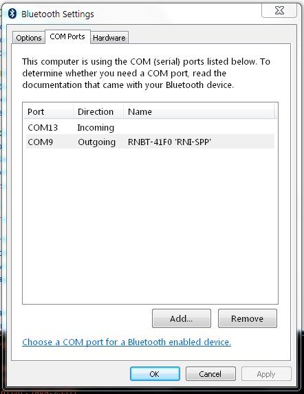

Yikes this is making me feel like a PC rookie.. (20 years desktop support in IT) one would think that i could figure this out
1st problem ide would fail with java error got that fixed by moving my schetch folder from my remaped my documents (on the server) to my local drive Error fixed
2nd replaced the dll and got my ide speed back up
3rd com port is in use error now (cant get around this)
I have deleted and reinstalled the bluetooth device drivers with the MS drivers
running windows 7 64 bit enterprize edition
so by default i did not have the out going comm port so i added that and now im stuck
i have the 5 wire cable connected to the RA and the 4 connected to my wifi (which works fine)
I assume this is a windows thing but im kind of lost on next steps..
also tested usb to ttl cable and that worked just fine
BT device that was found was a RNBT-41F0 so i assume that is the RA BT device
BT device when connected reboots the RA and the green light flashes (no blue light i dont get that far in the upload process)
Watchdog Timer
Version Menu
Dimming Signal
Date/Time Setup Menu
Standard Menu
Binary sketch size: 41,188 bytes (of a 258,048 byte maximum)
processing.app.SerialException: Serial port 'COM9' already in use. Try quiting any programs that may be using it.
