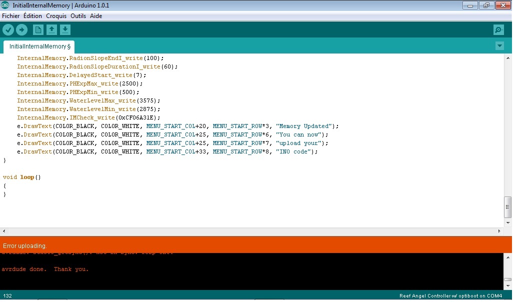

Re: Help!!! No internal memory found and dowloading error
This is the code
And this is my print screen
- Arduino error.jpg (131.17 KiB) Viewed 10412 times
Ok, it's not downloading.. It's uploading... That's why I was confused.
Can you copy and paste the error log in red??
This is a uploading error
Watchdog Timer
Version Menu
Simple Menu
Taille binaire du croquis : 6 812 octets (d'un max de 32 256 octets)
C:\Program Files\Reef Angel Controller\hardware/tools/avr/bin/avrdude -CC:\Program Files\Reef Angel Controller\hardware/tools/avr/etc/avrdude.conf -v -v -v -v -patmega328p -carduino -P\\.\COM4 -b115200 -D -Uflash:w:C:\Users\HPMINI~1\AppData\Local\Temp\build3020325183852794365.tmp\InitialInternalMemory.cpp.hex:i
System wide configuration file is "C:\Program Files\Reef Angel Controller\hardware/tools/avr/etc/avrdude.conf"
Using Port : \\.\COM4
Using Programmer : arduino
Overriding Baud Rate : 115200
avrdude: Send: 0 [30] [20]
avrdude: Recv:
avrdude: stk500_getsync(): not in sync: resp=0x64
avrdude done. Thank you.

Re: Help!!! No internal memory found and uploading error
Do you have RA or RA+?
Can you make sure that it is COM4 that your USB cable is using?
Ok, this is how I set the jumper when the error began.
Thereafter I handed the jumper to the normal position and I make all test, did not work.
Having put a jumper in the wrong position, can i have damage the RA ?

I am having the same issue and I also notice that the "base system device" driver did not install correctly.
This is the code I am trying to upload:
This is the error I get with trying to upload the initial internal memory:
Copyright (c) 2000-2005 Brian Dean,bdmicro/
System wide configuration file is "C:\Program Files (x86)\Reef Angel Controller\hardware/tools/avr/etc/avrdude.conf"
avrdude: Recv:
