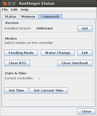

Does the Java status app have the commands in it?
Re: New to RA, Question on Modifying Menus
ufgators2k wrote:Does the Java status app have the commands in it?
Yes, it does have the basic commands in it. It does not have the Lights On/Off commands that were recently added though.
Take a look...

Curt - Is the source for the status app on your site?
Considering the link to the download is the github page :)
https://github.com/curtbinder/Status/
ufgators2k wrote:Curt - Is the source for the status app on your site?
yep, sure is. the project is an eclipse project.
