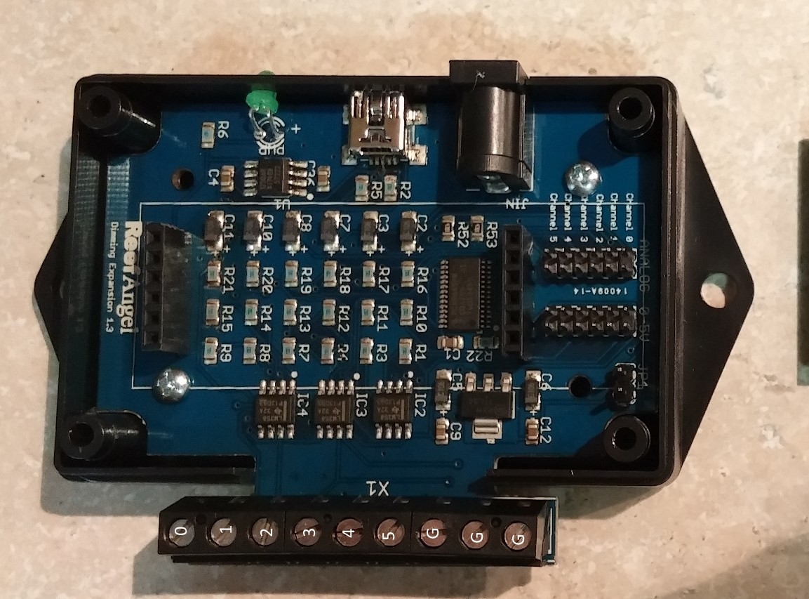

Got the RANet dimming module. Playing with it now.
Is 0x40 the correct address for the RANet dimming module?

yes. you don't need to do anything to the dimming module except configure your dimming signal voltage

Got it running. I took the daughterboard off to set the jumpers and couldn't figure out which way it went back. It was nice of you to make it only fit one way. :lol:

Re: RANet Dimming Module! Usage?
Posted: Wed Sep 10, 2014 4:29 pm
If you connect the wrong way, you can't close the box.

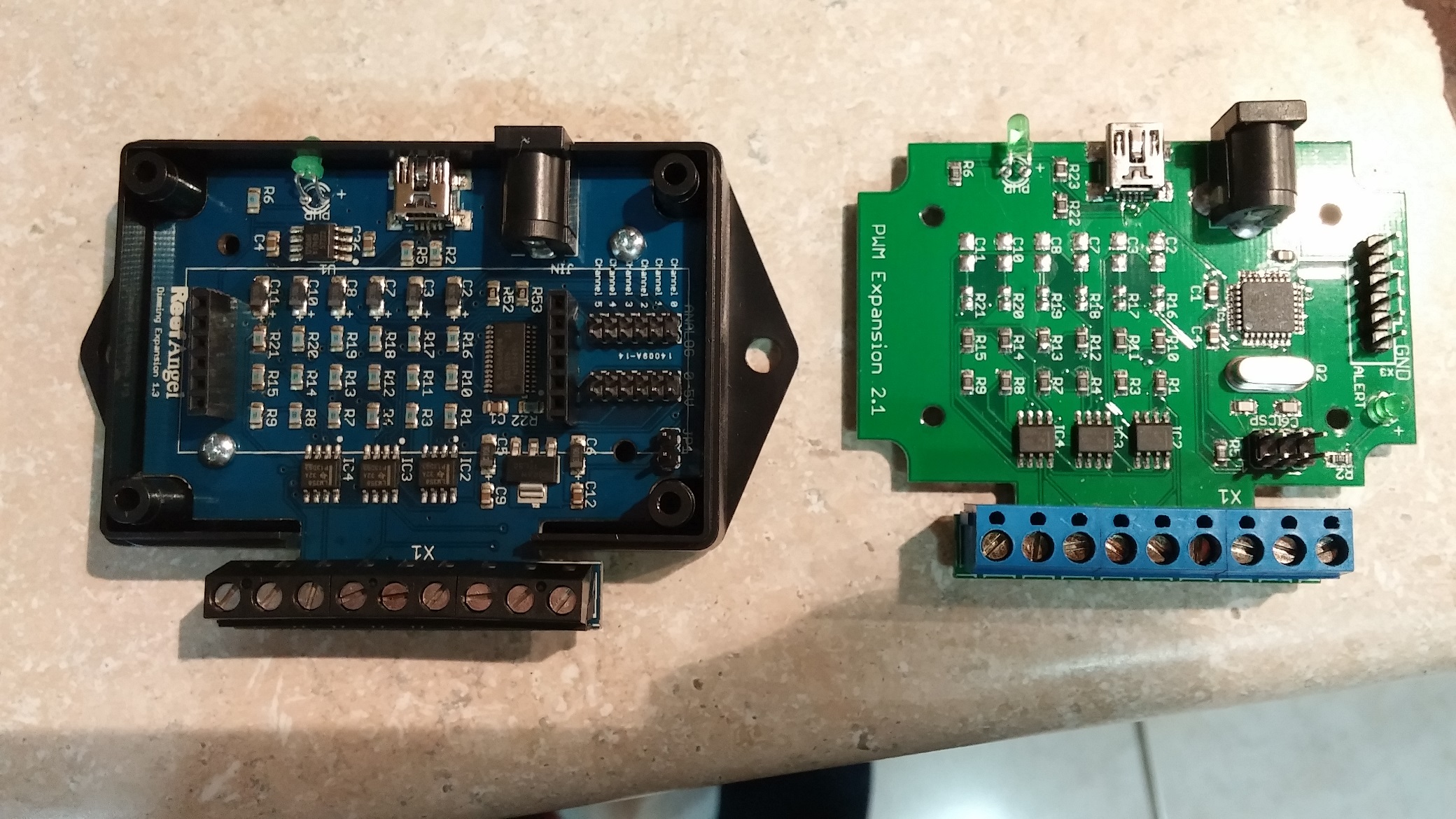

Posted: Sat Jan 03, 2015 3:15 pm
by bencollinz
rimai wrote:yes. you don't need to do anything to the dimming module except configure your dimming signal voltage
is this still the case? and where do I do that? and are the pin layouts the same as the PWM dimming module?

So, I'm OK if I put my wires in the same place on the new RAnet dimming as the old wired dimming?
