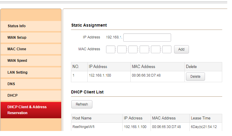

Re: connection issue with wifi
Looks like your router assigned another ip address to your wifi attachment.

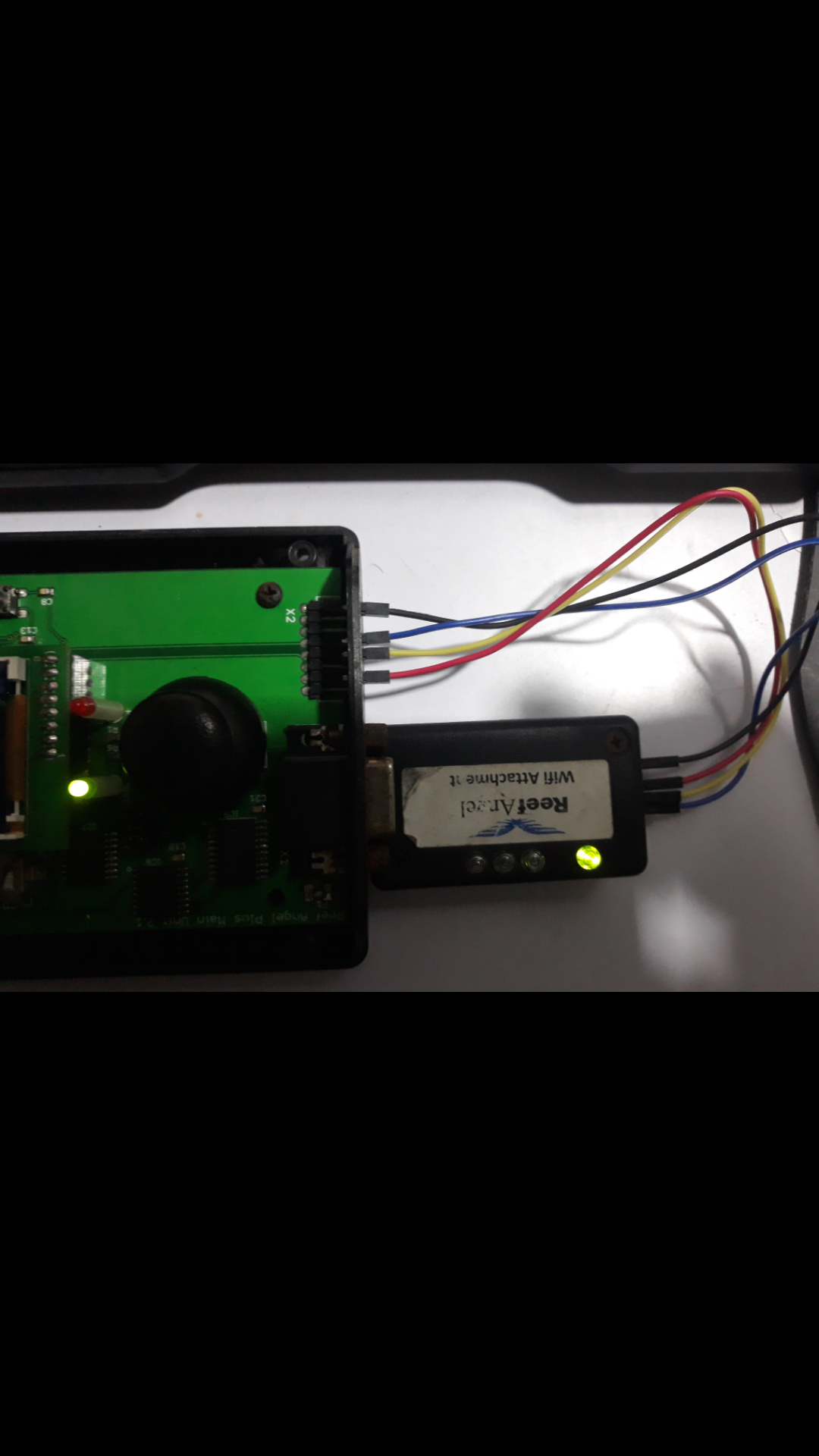

just now tryed to connect with the breadboard jumber cable the green light is blinking on wifi attachment but unable to open the 192.168.1.100:2000/wifi

check the attach pic for wiring diagram
still not working
getting error 13: No route to host
still not working

Is it just portal updates?
Are you able to connect to the ip address?
