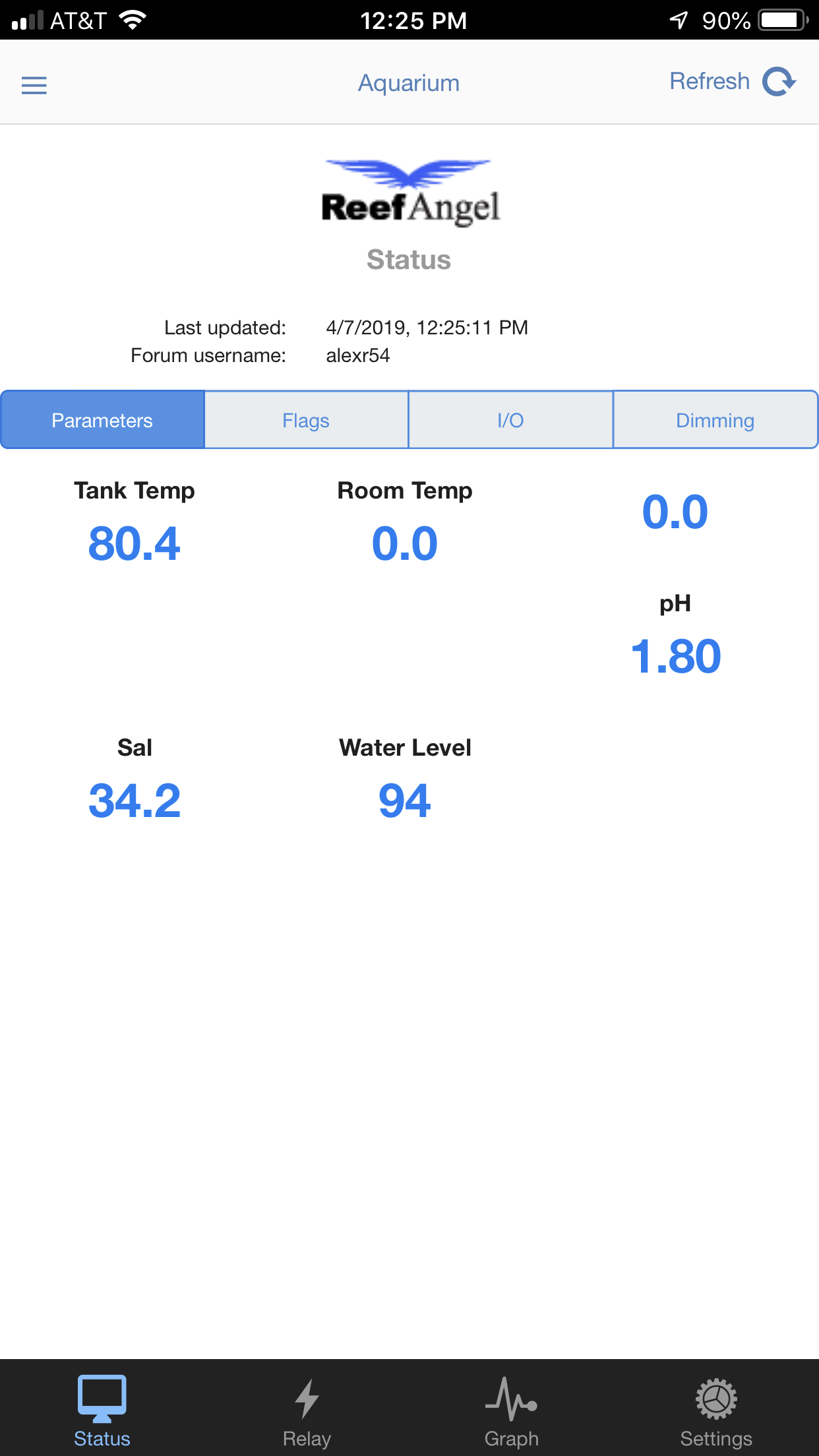

Seems no matter what I do I can’t get it to read correctly.
Now it’s at 1.80 while in the tank. It goes up when I take it out.

Post by alexr54 »
Pic attached

I just realized what’s wrong.
I have had absolutely no luck with several new parts I recently ordered.
The probe is faulty. The wire on top of the probe is causing the probe to not read ph. I need to mess with the wire to get it to read, but it is not stable.
This and the new temp probe is not working. No luck.
Fortunately the new salinity probe is working fine.
I have a new Ph expansion with probe on order. I hope that works good.
What can I do to get a replacement ph and temp probe for the faulty ones?
