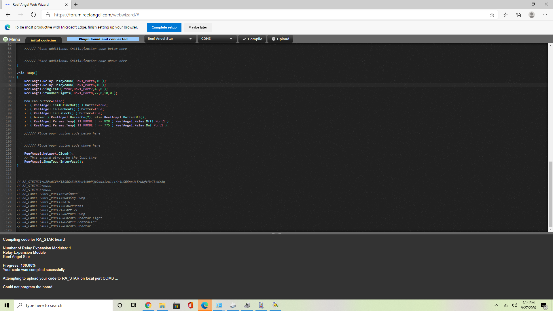

Re: Com 3 only option and i get Can not program Board in Wiz
heres the setup once i plug in RA.
ive tried running things in administrator mode, disabled any AV or anything like that as well
Very strange.... The unit does reboot when you open COM3 from command prompt but it doesn't when you initiate the upload from the webwizard...
Can you open developer tools on Chrome by pressing F12, then start the upload so you can see the log?
Please copy and paste the log here.
Looking again at the contents of the folder, i see no where on the machine where avrdude.conf is present. Almost like it doesnt get downloaded when i Install the plugin?
Yes, it did help.
Thanks for helping troubleshoot this.
I found the problem. Please reload the webwizard page and let me know if it works now.
- Posts: 152
- Joined: Thu Nov 14, 2019 2:51 pm
And we have success! Out of curiosity, is it something that i could of fixed if i have to ever re install or wipe the PC etc?rimai wrote:Yes, it did help.
I found the problem. Please reload the we bwizard page and let me know if it works now.
See below:
Awesome.
No, it was something on the backend here.
