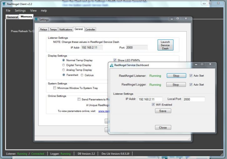

The reference is to the Reef Angel Client software.
Open the Client and go to Settings->Modify and choose General tab.
Click the button Launch Service Dash.
RA client screen.JPG (62.65 KiB) Viewed 7101 times
Make sure that you have the Listener service stopped before uploading any code.
