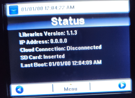

Hello-
My Reef Angel Star has been running for a few years. I had to move my aquarium and the Star was unplugged for a couple of weeks. When I plugged back in, I couldn't get it connected to the app or portal. It is plugged into an ethernet cable. I tried regenerating a new basic code with the wizard to at least get it up an running again, but the Star still says disconnected. Any help is appreciated!

Anyone have an idea on what to do?

Can you plug the ethernet cable into a laptop or other device to verify the router or switch is working?

brennyn21 wrote:Can you plug the ethernet cable into a laptop or other device to verify the router or switch is working?
Thank you for responding!
Yes I tried that. Has internet connection when plugged into laptop!

2 things to try is doing a full power reboot, not rebooting from the menu screen if that doesn't work. I suggest try changing the time on the controller to match the current time, then reboot from the controller from the menu screen.

brennyn21 wrote:2 things to try is doing a full power reboot, not rebooting from the menu screen if that doesn't work. I suggest try changing the time on the controller to match the current time, then reboot from the controller from the menu screen.
Yea I tried both those but no luck. I don't understand why the controller isn't showing an ip adress..

Can you login to your router and see if its getting an IP addresss?

I was trying to get this figured out before I went away, but was not able to. I wouldn't be able to check until my return at the end of the month I know how to log into my router, but how wouldI be able to tell if that is specifically getting an ip?

Sorry for the late reply hopefully you were able to get it resolved. if not you should have something called a DHCP Leases or dhcp list and that should show you a list of devices with IP address
