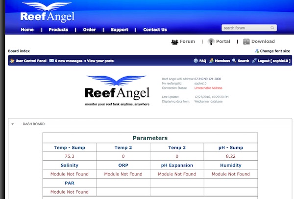

Hi Roberto, I used the wizard (slick!), and used my 192.168.0.11 for the ddns, and I found my info on the portal (see below)! Everything looks fine, except the connection status shows 'unreachable address', is the norm? The data is accurate!rimai wrote:The preloaded code is not customized.

Uh oh, While I see my system in the portal, I notice that while the temp and pH are accurate, the the range is wrong. It only has data to 12/26, but the last update was 12/29 at 9:41 (just did one). I also can no longer access my RA from within my own WIFI using 192.162.0.11:2000/WIFI. What did I do?
Re: How to setup your wifi attachment
The path is case sensitive. Sorry.
Also, your address seems wrong. Usually, they are 192.168 and not 192.162 on most routers.
It needs to be http://192.168.0.11:2000/wifi
Also, in order for the portal to connect to your controller, that's when port forwarding comes in.
By default, all routers block any external access to inside your wifi network. That's what they are designed for. It's called firewall.
So, the portal has no way to access your controller.
Port forwarding allows a specific port to be forwarded to a specific ip address, which will allow external connections to reach your controller.
You need to setup your router for port forwarding. It needs to forward port 2000 to your RA ip address 192.168.0.11
