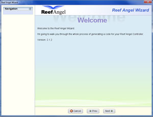

All I get is a welcome screen with this on it. Nothing else. No place to click to continue nothing.
Welcome to the Reef Angel Wizard. I'm going to walk you through the whole process of generating a code for your Reef Angel Controller. Version: 2.1.0.
Re: New System
You don't see the buttons at the bottom?

I only have 2 choices on resolution and both are cutting off the bottom of the page. When I try to drag the screen up to see the bottom it won't let me.
				smcglaughn
- Posts: 67
- Joined: Tue Sep 18, 2012 8:00 pm
- Location: Spruce Pine Alabama
Re: New System
1024X600  I can change it to 800X600 those are my only choices.
Re: New System
Yeah, you won't be able to use the Wizard at this resolution.
I can generate the code for you if you tell me what you would like to do.
