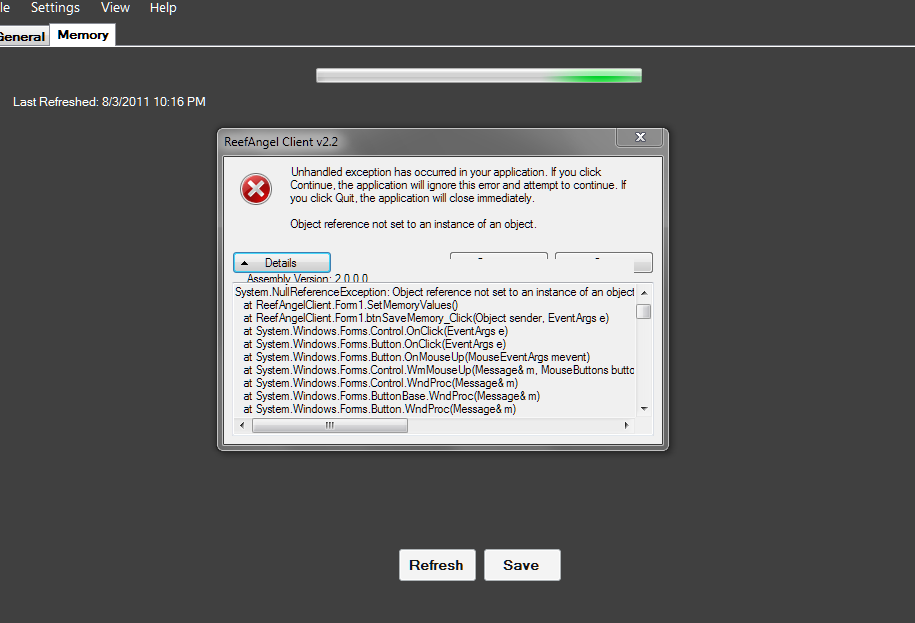

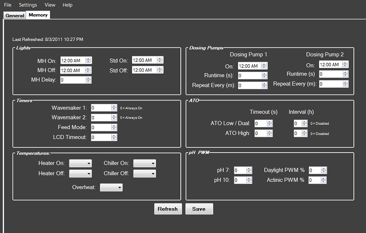

Hello:
Small little bug I found in 2.2, seems if you forget to load the memory settings the temperature dropdown boxs are unpopulated. Trying to save results in a app crash. Perhaps a default value in temperature dropdowns or a warning message before continuing to savel.
Cheers

Thanks for the heads up, Bryan.
Ideally, when you push the Refresh button - all those input fields should be populated with the correct data from the controller. In your screenshot it looks like they're all blank/defaulted to nothing. This shouldn't be the case. The save button should not let you save a bunch of blanks to the controller. Instead, on a failed request for memory values from the controller, a message should appear letting you know something went wrong and you would have to do another refresh. Until a successful pull happens, none of those fields should be visible. I must have missed something.
Could to you got View-Error Log and see if there's anything in there? If it's huge/ filled - just clear it out and save/close. Then try to reproduce the problem and copy me just the relevant logged info.
-Dave

In this case I reprogrammed the controller without programming the memory settings first from RAGEN.
I can reproduce the issue tonight and send you the log.

Curt uses different memory locations with his dev libraries, than what the Standard ones use. Unless you manually wiped out the memory values, everything should work okay. That's the biggest advantage to using the client app - you upload Curt's memory sketch only once, and then can swap around the RA sketch as many times as you want, relying on the client to change memory values.
Re: Client Suite 2.2
He's not a normal user. He uses a programmer instead of bootloader, which erases memory everytime he uploads a new code
dmolton
Posts: 182
Joined: Tue Mar 22, 2011 11:08 am
Post by dmolton »
rimai wrote:He's not a normal user. He uses a programmer instead of bootloader, which erases memory everytime he uploads a new code
Oh.. Oh My :lol:
So I guess the read didn't fail - it just returned nothing back or whatever the defaults are. I'll work in some additional checks for setting memory.

Oops, sorry should have mentioned I am using AVRStudio and flashing with a Dragon. Normally I flash the memory hex file first, but forgot.
