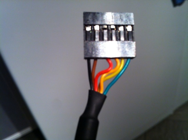

Yeah this code works in the Reef Angel and I see in the screen when the port it is opened and closed. But I think the Uno does not receive the order of ReefAngel, cause I have no signal on the UNO pin.
I wonder if I correctly connect the Uno to RA. I connect the Uno with Usb port of the relay box. Do I need to put a jumper on the UNO?

AquaO
Posts: 61
Joined: Sun May 27, 2012 11:22 am
Need custom code for custom expansion
Post by AquaO »
This is the cable
Osaka 40g with 55g sump
Radion, 2X Tunze 6045, Swc-160 mini cone
Re: Need custom code for custom expansion
no, you need to create your own cable.
Just buy a regular USB cable and strip it.
Google for USB pinout.
D- goes to A4
D+ goes to A5
