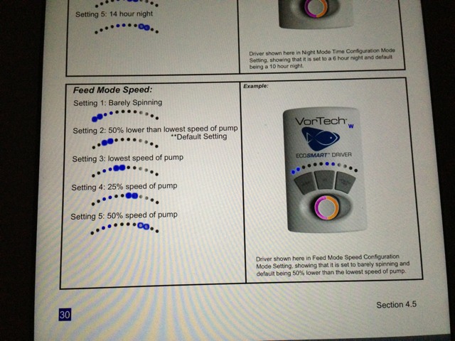

You can change feeding mode speed. Default is 50% but you can make it "Barely Spinning"

will investigate that thanks.
edit: reading the manual it says you can power off master/slave chain by holding power off button.. guess i need to crack open an eco smart and then look at the rf schematic to figure that one out.
