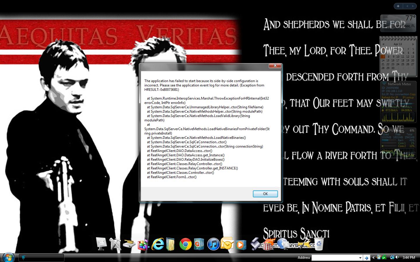

This is the error I am getting trying to run the program. I can run the dashboard and listener will run, logger will run, but when I switch notifier on, logger will stop.
- error.jpg (181.45 KiB) Viewed 15841 times

Re: Client Suite 3.0
@Paulturner911:
It seems to be usually related to the VC++ redistributable... I imagine the installer ensures that you have the right one though. (Perhaps it doesn't, or maybe if it used to work you have installed something that changed the version of the library you had...)
Maybe try reinstalling the client?
Otherwise I think you'll have to wait for the author or someone else familiar with .Net programming to respond... I won't touch that stuff
