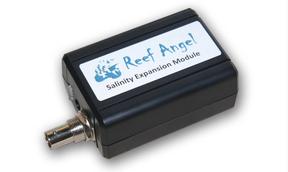

I know some of you have been waiting for these quite some time.
I have a very very limited quantity of these available at $149 each.
It comes with the following:
  • Salinity Expansion Module
  • Salinity Probe
  • 12 VDC Power Supply
The libraries for this module is not yet fully developed.
I'll be working with Curt to get it added.
If you are interested, please PM me.

Yeah, that's the reason I have always been against investing so much time and effort into getting one of these out, but since there had some interest, I decided to just give it a shot.
I could sell just the module for $60, but it would be no good without the probe. The probe is what is really expensive.
They work by measuring the electrical conductivity through the water. So, the probe needs two metal leads that conduct very tiny amount of electricity through the water and they are made out of platinum to avoid corrosion, which unfortunately drives the price point to the upper side.
