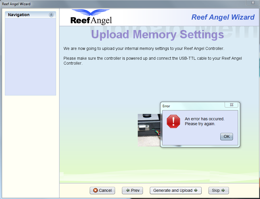

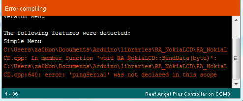

Hey guys I keep getting the following error when compiling the InitialInternalMemory or any other internal memory memory code generated by the wizard. I have tried deleting the \Users\brett\Documents\Arduino folder and re installing but no luck. What could be the issue?
Simple Menu
C:\Users\brett\Documents\Arduino\libraries\RA_NokiaLCD\RA_NokiaLCD.cpp: In member function 'void RA_NokiaLCD::SendData(byte)':
C:\Users\brett\Documents\Arduino\libraries\RA_NokiaLCD\RA_NokiaLCD.cpp:640: error: 'pingSerial' was not declared in this scope
Re: Error when compiling InitialInternalMemory
Make sure you are using libs 1.0.5
Download the latest RA Installer from the website.
It has been updated a few days ago.

downloaded and installed the latest 1.0.5 tonight.
When I go to Tools/Reef angel libraries version it confirms that I am using 1.0.5
bug :(
Use this file instead:
RA_NokiaLCD e;

I'll update the RA Installer with this new file.

InitialInternalMemory compiles fine now but any memory sketch generated by the wizard gives the same previous errors
