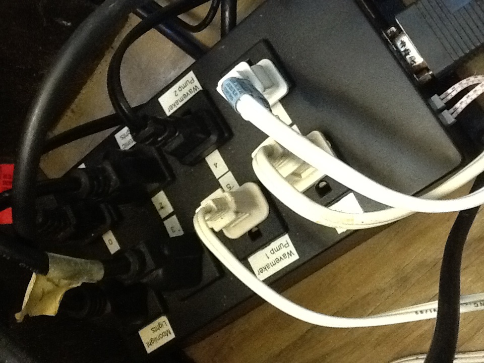

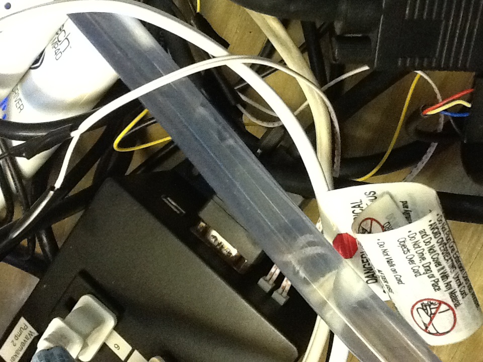

Can you PM me or post a photo of your relay box??

Post by homerclease »
Top
Top

Re: dimming output questions
Top

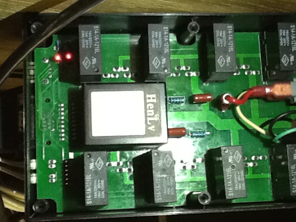

Ok, I'll need a photo of the inside now.
Ok, so you see where the dimming ports are?
There is a 6pin header close to it.
That's where the PWM booster would be and I can see there is none.
So, luckily for your case it is very simple to do.
I can send you a PWM booster board that would be plugged in that header pin.
