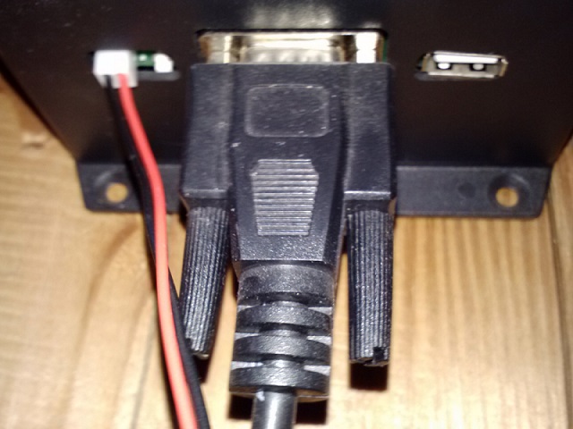

I believe I have the 2nd generation Relay Box. I remember the change was that the relay ports switched. The Relay Box I have has Port1 on the top right. Here is a picture of the bottom of the Relay Box.
I measured the voltages on both 2pin connectors and they were both 0.5V. Here is a picture of it.
Re: Jabeo WP40 - Reefcrest mode won't work
Yeah, can you open it to check?
I think it is one of the older models that did not have the PWM built-in.

Here is a picture of the inside of the box. I noticed 6 pins inside the box on same side where the two 2 pin jumpers are on the outside. I also included picture of those. What exactly am I looking for to tell if it has PWM?
Yeah, you need the PWM boosted to plug on those 6-pins.
PM me for one of those
