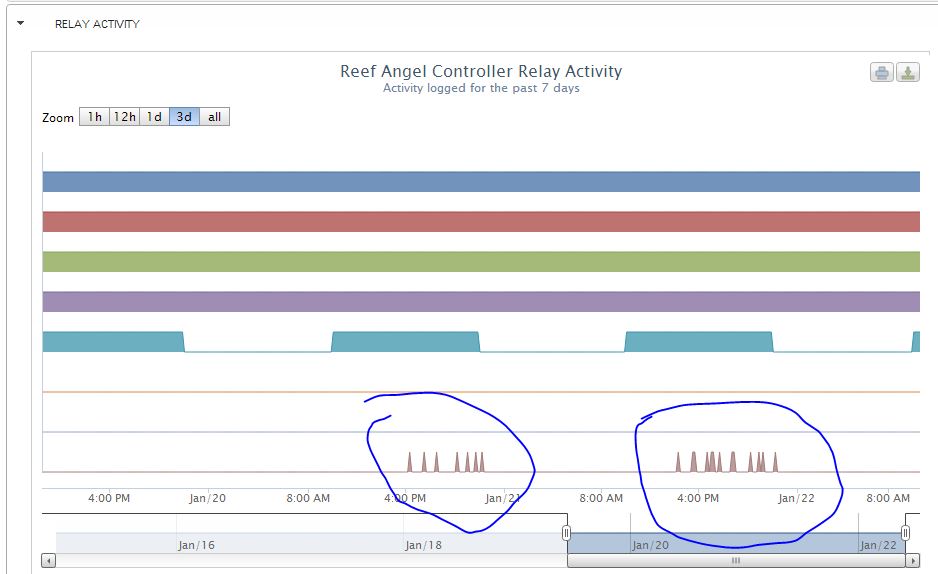

I think I may be having the same issue but I'm using LEDs on PWM. I notice that my log shows that the ATO stops acting up once the lights dim down to 1% for the night. See my ATO relay log below, note that the actual water level was between the two floats this entire time.
Re: T5 ballast causing ato troubles
The Portal only register events every 5 minutes.
If the event is quick, it won't register.
What I think you are seeing is just more evaporation during the day.

Post by mls228 »
I disagree. This happens anytime the high limit switch isn't active. I have about 2.5 days of evaporation between the switched. I think I'm getting this noise issue much more frequently than every 5 minutes but it just catches a few in the log. I'll try cleaning up the wiring to see what happens.
