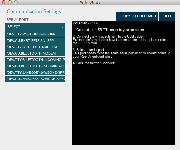

I have a macbook pro running 10.9.1 mavericks. I installed the usb serial driver rebooted, and no matter what I do I cannot get my mac to talk to the reef angel or wifi adapter via their respective pieces of software. I installed the bluetooth adapter to the reef angel and that worked like a charm.
Unfortunately I cannot figure out how to daisy chain this wifi adapter and blue tooth module to program it so I'm trying to do it via the USB connection as instructed by the forum. I have attached a screen shot of what I get whenever I try and communicate with the wifi adapter.
Screen Shot 2014-01-03 at 8.44.35 AM.png (34.71 KiB) Viewed 8084 times
Re: Newbie USB mac question
How many tty.usbserial you have listed?

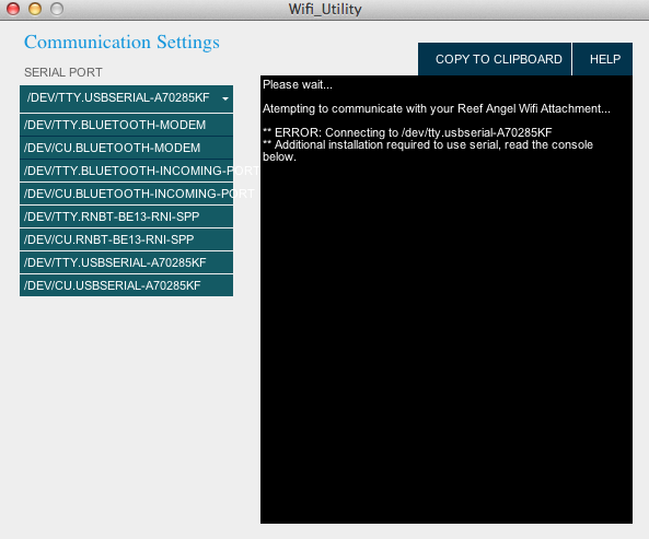

This is what shows up on the drop down.
Screen Shot 2014-01-03 at 9.19.16 AM.png (54.38 KiB) Viewed 8078 times

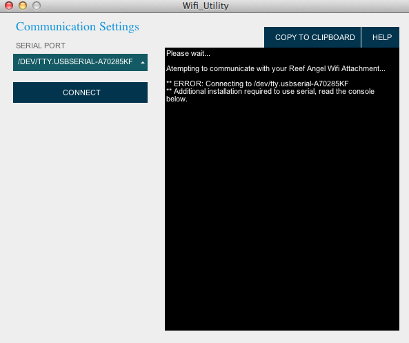

The tty.usbserial is not there anymore, did you unplug the usb cable?
Can you post a photo of how you are connecting the usb cable to the wifi attachment?

Post by Leafies »
Sorry it was unplugged when I ran the screen shot last time.
Screen Shot 2014-01-03 at 9.50.51 AM.png (51.43 KiB) Viewed 8071 times
Oh, I can see there is an error code there about additional installation.
I think this is what is preventing you from getting it configured properly, but I don't know what additional installation it is that it is referring to.
Can you try a different computer?
Otherwise, we will need to manually configure it using Coolterm
May be worth a shot....
Try using an older version of the wifi utility:
http://download.reefangel.com/download/ ... _1.0.1.dmg
Don't use the libraries or Arduino app from this image. Only use the wifi utility.
