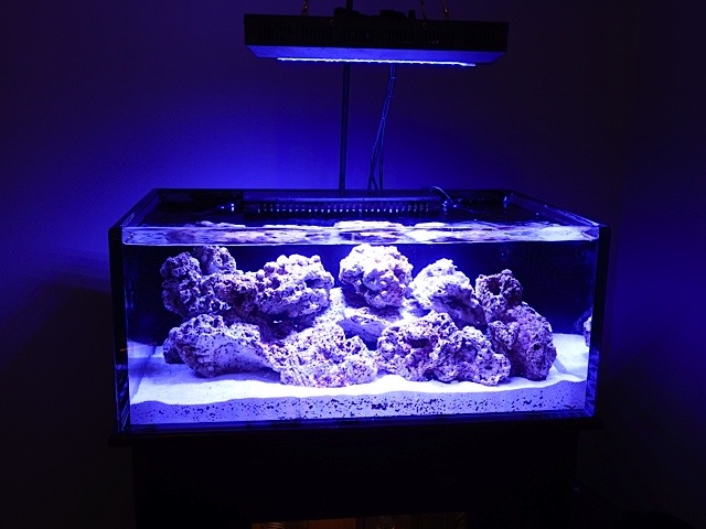

Pic of the tank with lights on. The lights are not fully tuned in yet and no final aquascape.

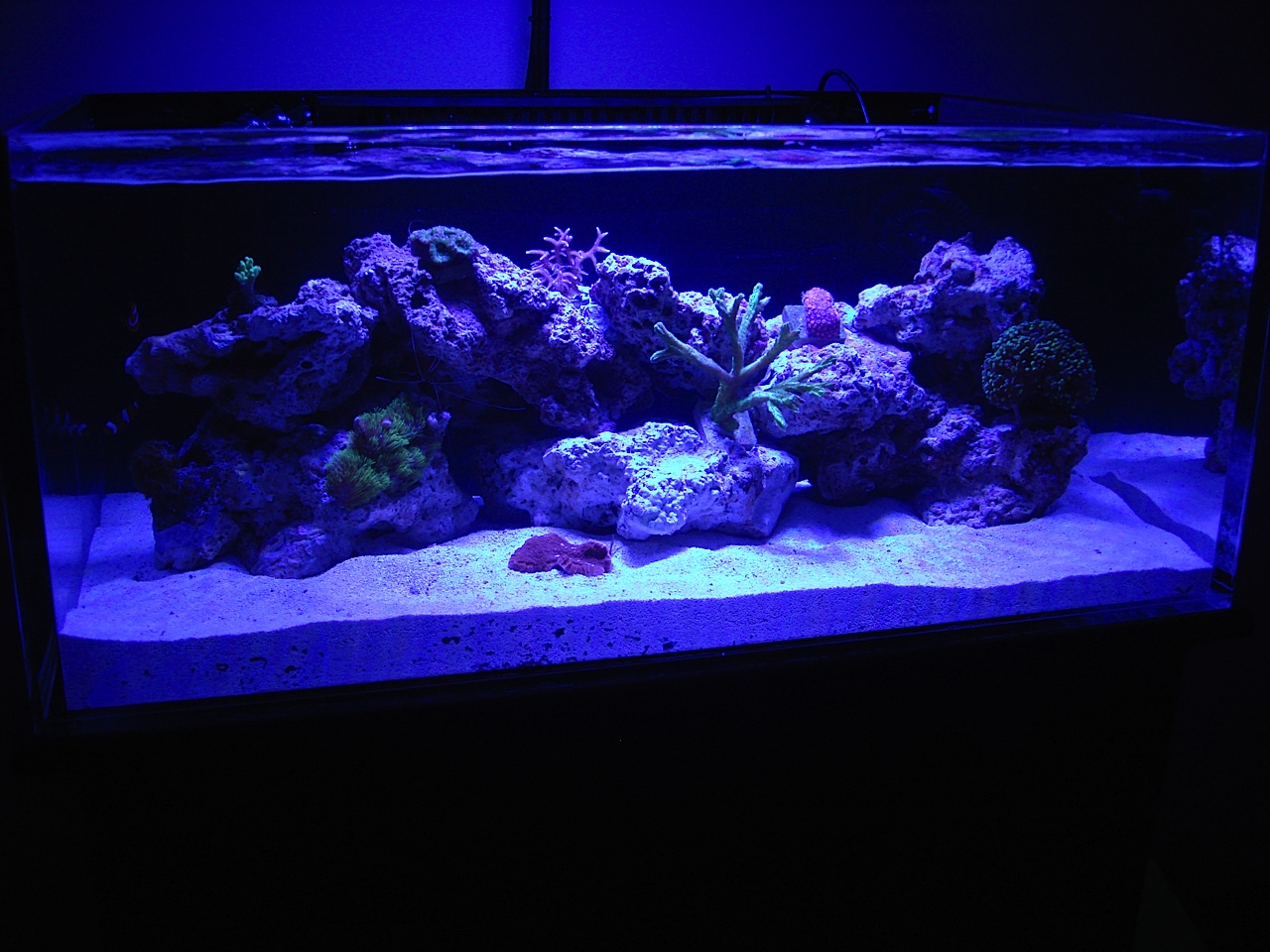

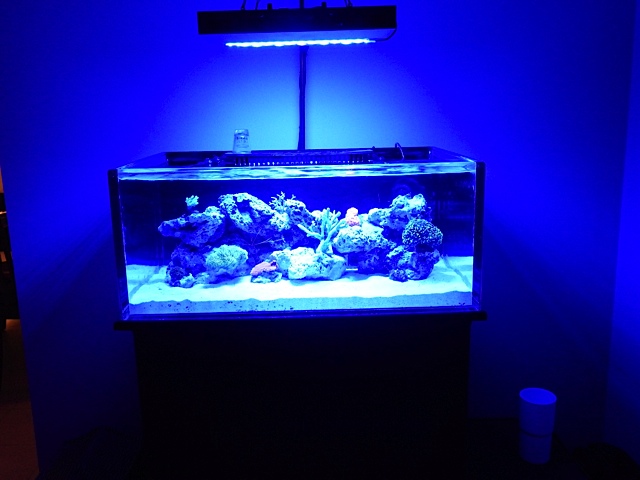

Blues and moonlights on. I will get another pic uploaded in the morning when the the sunrise and sunset phase starts

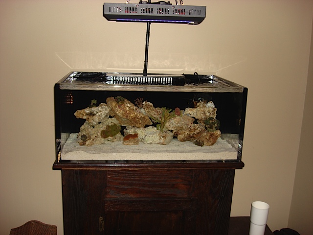

pic with D120 off
