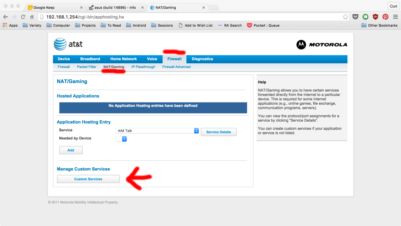

First off, open up your modem/router’s webpage, typically this is 192.168.1.254. Once there, you will need to navigate to the “Firewall” tab/section of the device.
Once on the Firewall page, choose the “NAT/Gaming” sub-tab.
This page is where we will be doing all the port forwarding. It is confusing and took me some time to get it figured out. This is not the same as your typical router. Your typical router is going to allow you to specify everything manually. This router just gives you a pre-defined list of “services” that are already configured (so you don’t have to configure them, you just have to select them) to choose from. Since we are doing our own for ReefAngel, we need to create our own service to be displayed in the list.

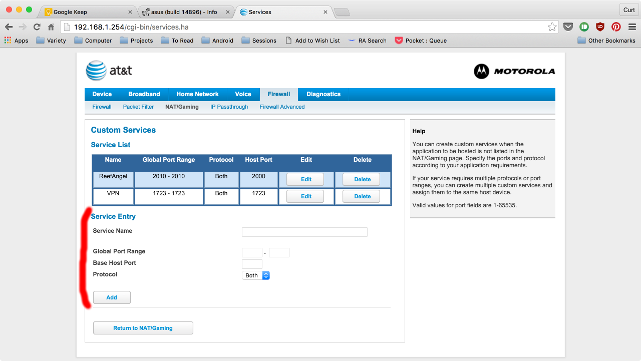

Here’s how to do that. Click on the “Custom Services” button. It takes you to a Custom Services page and displays the services that you have created.
As you can see on my router, I have created 2 services: ReefAngel and VPN.
We will create the ReefAngel service for you to use. Under the Service Entry section, you will need to input this information:
Service Name: ReefAngel
Global Port Range: 2000 - 2000
(I chose 2010 for my setup because that’s how I wanted it setup. This is the public port that you will be using when communicating OUTSIDE your network into your network.
Some people do not want to use the default port to connect to their network. If you wish to use a different port other than the default to connect to your network, this is where you change it…not anywhere else. If you do not understand what I am talking about, then just ignore what I said and enter what I put down.)
Base Host Port: 2000
(This it the port on the INSIDE of your network. This MUST be set to 2000. This is how your wifi adapter is configured.)
Protocol: Both
(This can be set to only TCP but it will not hurt anything. It is safest to just leave it to BOTH.)
Now, you will click the “Add” button and it will create the service and add it to the list of Services. Once it shows up, you can then click the “Return to NAT/Gaming” button. This will take you to the previous screen.
The last thing you must do is to add the application (service) to the list of Hosted Applications. All this means does is tell the router/modem to allow data for the specified service to pass through the firewall (aka, open up a port on the firewall and allow it to goto a specific device).
Under the Application Hosting Entry section, choose the *ReefAngel service from the dropdown menu next to Service. There will be an asterisk next to ReefAngel indicating that it is a custom service that you created.
Next, for Needed by Device, choose your reef angel device. This is where you will have to do some checking on your own. There is a drop down list that gets filled with all the available devices on your network. So every device connected to the router will be listed. I do not recall how it is listed. It may be by MAC address, it could be by host name or simply IP address. You will just have to see what your list displays and go from there. I believe the hostname for the wifi adapter is WiFly or something along those lines.
Once you have entered the information and chosen the device, you will click the “Add” button. Then the application will be displayed in the Hosted Applications section to show that it is active.
Now you should be set to have the router forward the traffic to your ReefAngel (provided you chose the correct device).

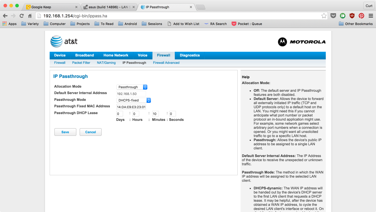

If you wanted to do the cascaded router option (like I have setup), here’s how you would do it. Ignore all the information above. You will also have to configure the cascaded router to allow for the Port Forwarding. So if you had your previous router setup and working, you could put it behind this ATT modem/router and everything should work as before.
One caveat is that your internal network range should be different than the one on the ATT device. The ATT modem/router uses the 192.168.1.X network scheme. So your cascaded router should use something different. I use 192.168.2.X on one of my networks and 192.168.3.X on another.
Browse to the router’s web page (192.168.1.254).
Once there you will need to goto the Firewall tab.
Goto the IP Passthrough sub-tab.
You will need the MAC address for your cascaded router’s WAN port. You will be plugging in your cascaded router to one of the network ports on the ATT router and then that cable connects to the WAN port on your cascaded router.
Use the following settings:
Allocation Mode: Passthrough
Default Server Internal Address <ignore this>
Passthrough Mode: DHCPS-fixed
Passthrough Fixed MAC Address: <ENTER YOUR CASCADED ROUTERS MAC ADDRESS HERE>
Passthrough DHCP Lease:
(I have 10 minutes here but you can leave it be 1 day, which is typically the default for DHCP. I have it set to 10 minutes because I have had issues in the past with my setup where my router would lose its connection to the ATT modem and it would not get the public IP pushed through to it and I would not be able to connect into it. My internet would still work but I would not be able to remote in. So I set the lease to be a short time frame.)
You can then press the “SAVE” button. This will save the settings. Make sure your cascaded router is plugged into the ATT router and then reboot the ATT router. Your cascaded router should pick up the IP address and start doing its job.

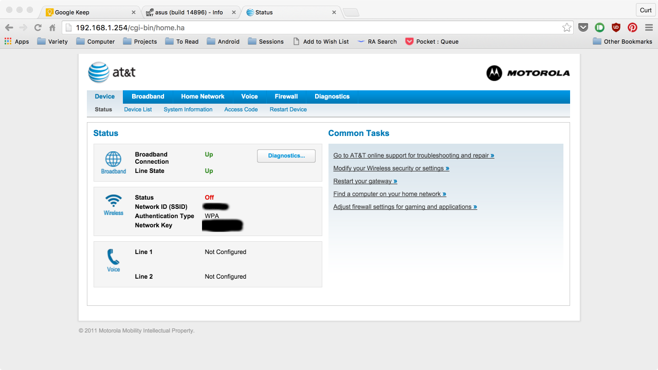

Lastly, you will want to disable the WIFI on the ATT router so you do not have any issues.
By doing all this, you essentially bypass the router portion of the ATT modem/router and use it strictly as a modem. You can still get to the device by using its ip address if you ever had to change anything on it.
You can use either of the 2 scenarios I described above. Both options work. I have used them both. I prefer the cascaded router setup simply because I prefer my own router with DDWRT code (like I mentioned previously). I also have my router do static dhcp ip leases for my device so I do not have to manually setup the IP address on my devices. It's just simpler for me this way. I've changed the IP scheme on my network too many times along with the IP of devices and have been annoyed by having to manually configure each device that has a static IP address. So I prefer my DHCP server to do all the hard work for me.
You just use what you feel most comfortable with. Hopefully all of this makes sense and is a little easier to follow with screenshots.
Let me know if you need additional help.
