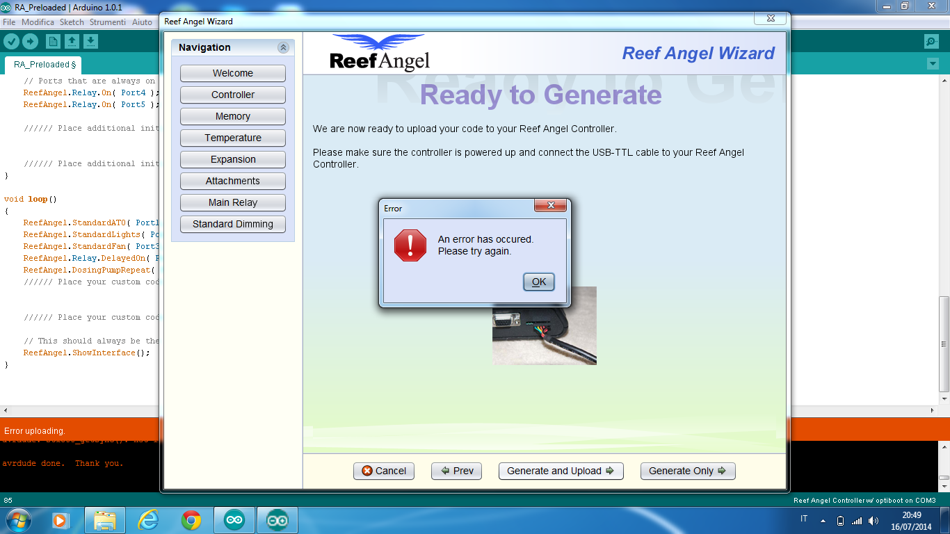

I tried to open the relay box and now tells me when I load error uploading as photos, reef angel and remain green in the door 6:08 sketch Fitting something but if they do not go nowhere, what do I do I'm desperate, I have a ceiling that without the pwm output does not turn on: (

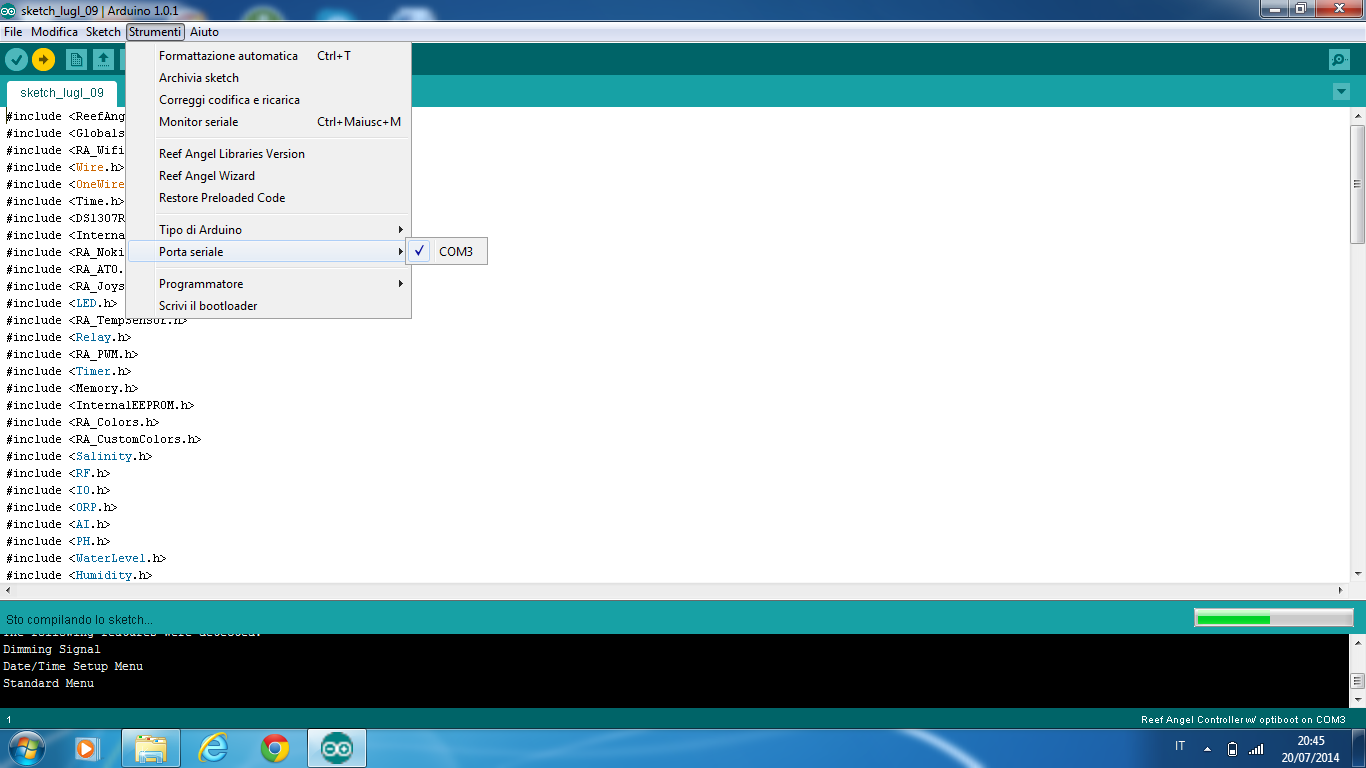

how do I verify this? tells me com port 3
Re: problem reef angel not fuction
Choose another listed port until you find the one that works.

how do I choose which port to use? me alone with 3

see problems
Unplug the cable from the computer and see what ports you have then.

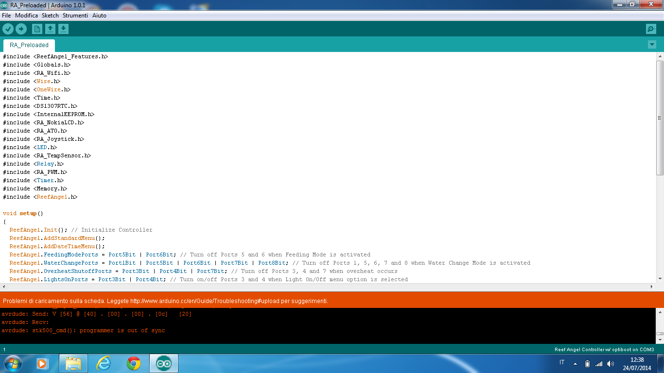

I tried to uninstall everything and delete all folders from the ra pc, I updated USB ports pc, and I see that as soon as the sketch Fitting ttl cable to the PC do not recognize the sound and at this point I do not think it's the cable and not ttl I know what it is, now I get this error.
problema scheda.png (114.55 KiB) Viewed 8952 times
I think it is your head unit then.
