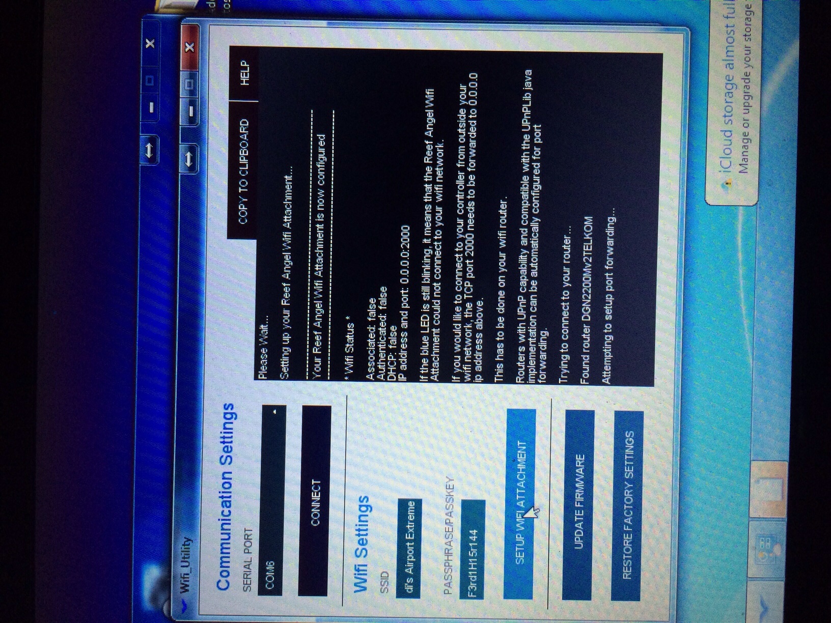

I have a Netgear router that only gives internet access to my Apple airport extreme(Netgear wifi radio is off).
When i do the setup of my ReefAngel wifi module it will not go further than "Attempting to setup port forwarding..."
It is also picking up my Netgear router DGN2200Mv2TELKOM.
Does anyone have the same or similar setup?
Please see photo i took.

Both the SSID and password are case sensitive.
Make sure they are typed correctly. Also, I'd try changing the SSID to not included the apostrophe. Try using only alpha numeric characters.

Hi Roberto,
:oops: i went the next morning and checked every single letter. Like a palm to the face i realized that the AirPort that i typed in was spelt with a lowercase p :oops: :oops: :roll:
Thanks for the help
