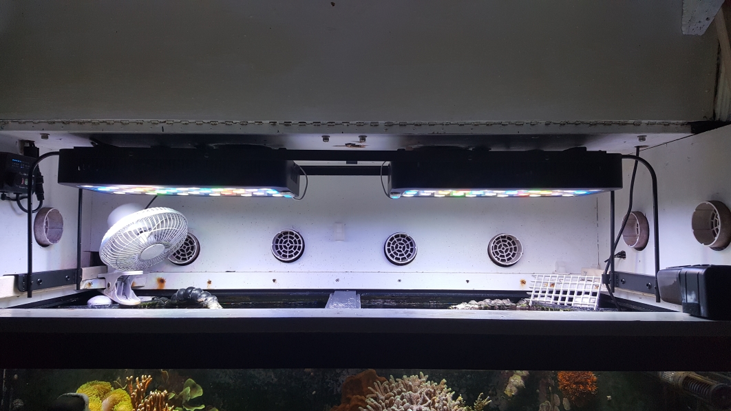

Got my SB ReefLights all modded up. I used a stereo headphone jack placed in one of the dimmer pot holes and made a wiring harness using a 4 pin circuit board connector so it's all just plug in with no cutting into the original wiring. Works great. My only gripe is that these drivers don't dim to off so it took a little bit of coding and 2 ports on my relay box to get it to work properly.

Nice work.
