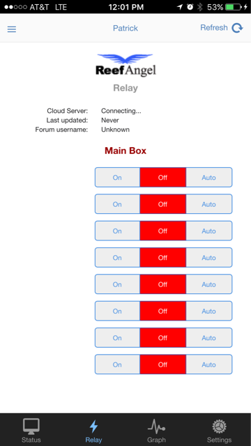

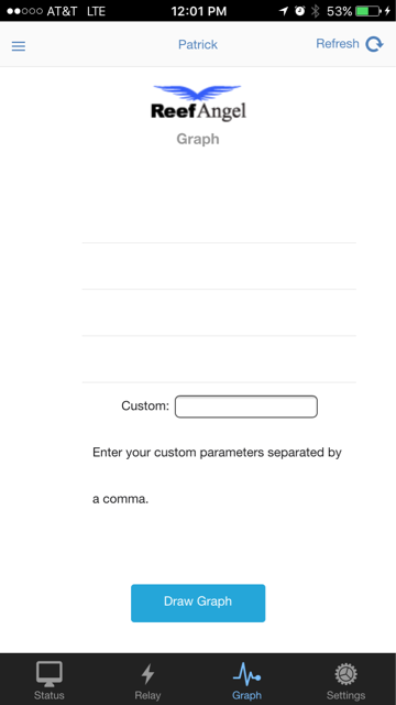

I agree. I finally got it working with the IP address. I had to uninstall the app and reinstall. Worked like a champ after that.
I can "get RA version" without issue.
I can Sync with portal without issue.
I can reboot contoller without issue.
But I cannot see any data. Continues to say "disconnected" or "connecting"
ideas?

Re: New IOS update today
It worked for about 5 minutes... then went back to not connecting.
I think I'm going to remove the cloud server settings.
It's meant for upcoming stuff and it should not be used.
That's what is causing it to fail for you.
If you see "Cloud Server: Connecting", it will fail, because your RA is not capable of connecting to cloud server.
Did it work for you without the cloud server settings? Just leave it blank.
You may need to delete the profile and setup it up again.
Just wanted to confirm this is the case. I'm 99% sure it is that.

rimai wrote:Did it work for you without the cloud server settings? Just leave it blank.
Yessir! sorry about that. I misunderstood. Thought you were saying there was something on the back end that needed changed.
Once I removed the Cloud Server (forum username/password) it functioned perfectly!
Thanks for that!
Yep, that fixed it for me. Looking forward to hearing more about the starboard.
