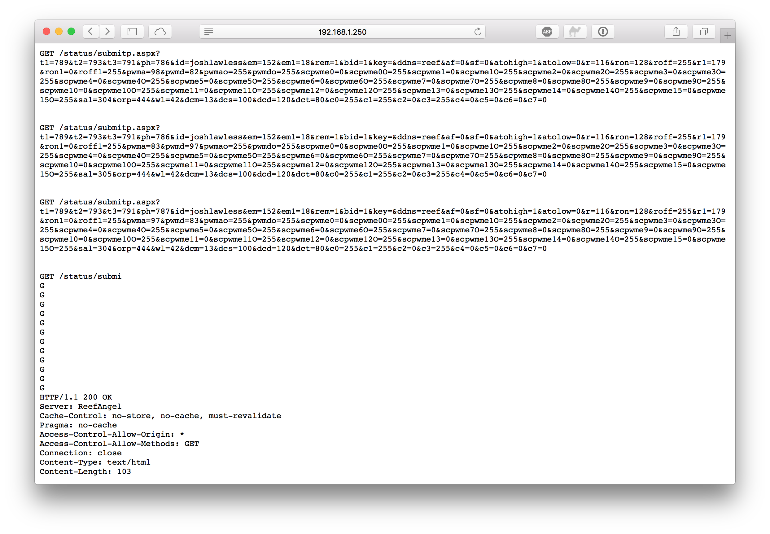

I've been dealing with inconsistent WiFi performance for a while - sometimes the phone app will stop working for a while (with an error message about "Unable to process controller data"), but I can proceed immediately to the laptop and access the web page without issue. Sometimes even the web rendering doesn't work properly, however, as shown in the attached screenshot:
Is this an issue on my end, or at the reefangel.com hosted side?

Try updating the wifi attachment with the tera term macro.
http://forum.reefangel.com/viewtopic.php?f=3&t=4601
