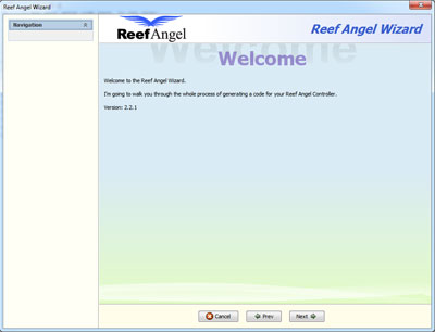

Im trying to use the app but it says 0 for everything?the wizard just tells me it will help me. wont do anything else
Re: Need my tank coded. Please help
Huh?
I don't think you are using the wizard.
Open Arduino and go to menu Tools->Reef Angel Wizard.
It generates a customized code for you to load in your controller.
The stuff you post above was for the wifi attachment utility which sets up your wifi attachment to connect to your wifi network. It has nothing to do with the controller customization.

Yeah and it just says welcome and what not. In navigation where drop down list should be.nothing there
Click the next button.

Its not giving me that part of the page haha.i think it may be my moniter. Trying it on gfs laptop...i figured it would say next but it doesnt
shimmerlessreef
Posts: 27
Joined: Thu Oct 13, 2016 11:45 am
Post by shimmerlessreef »
I had to mess with screen settings. Thanks
