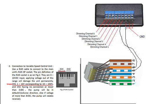

I had limited discussions with Eric from Fishstreet. I've attached a drawing for what I think I'm supposed to do. He said that 5 and 6 are for speed, 1 and 2 are for direction.
I don't think we would worry about direction with a DC pump? So 1 and 2 are not needed?
Another stupid question, is this 0-10v pwm or 0-10v analog? There's such a language barrier with them, it's hard to understand. (and I'm green with a lot of this that may be obvious to some

How do you have that connected to the RA? I assume an rj45, but which pins?Ismaclst wrote:Sorry, I don't have this controller. I run a waveline pump.

I think I have most of this figured out.
Does anyone know if the signal is PWM or Analog?
I've seen posts that its pwm, and then the A1 manual says analog???
Edit: after more digging the Apex is analog, as is the waveline, as is the A1 controller if it's to work with the Apex. I hope to order a pump/controller soon and will update this thread.

I can confirm the reef angel connected to an A1 controller will control a DCP 10000. It is 0-10v analog, and you can see the pinout in the manual. It is pins 5 and 6 for speed.
So I guess this means for anyone with DCT, DCS, or DCP pump you can now control it. I must say I was hesitant about buying the DCP, but it feels/looks really well made. I've seen pictures of the DC series jebao, and it looked like junk. What does this mean?.......absolutely nothing, but I'll be sure to post back if anything fails.
I was able to get the DCP to flow at 10% and higher via the app. I'll take some pictures when I get it plumbed in the tank, now it's just in a bucket.
