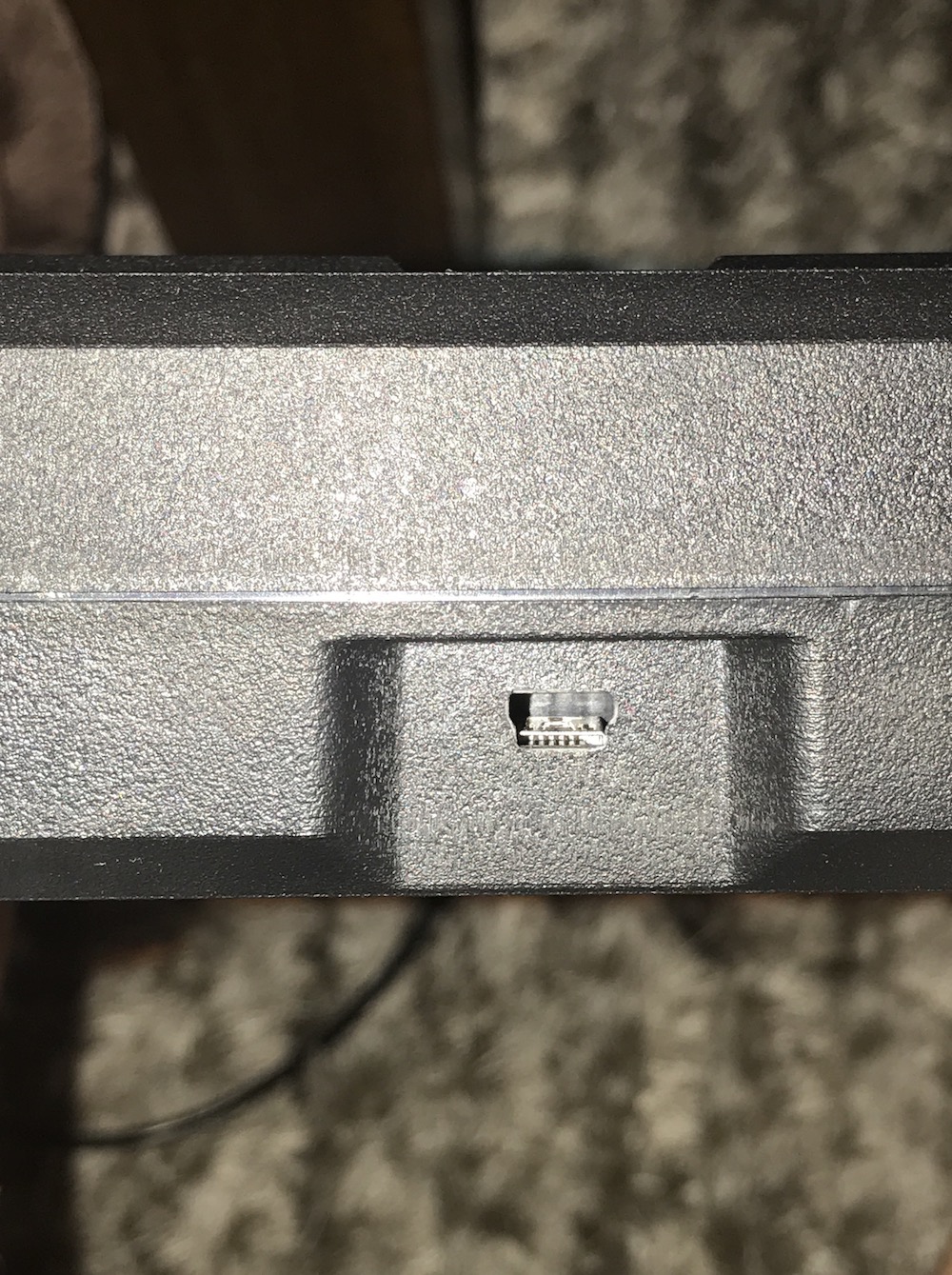

I have the RA Star which came with a relay box with Mini-USB connector. It seems that the plastic cover is mis-aligned with the port. So I can't actually plug-in the cable.
Has anyone else had this issue? If so how did you solve it?
I know that I can simply dremmel the hole bigger, but I'm worried that surface mounted USB connector will fall off unless the cut-out is helping to hold the plug in place.
Any thoughts will be greatly appreciated!

It shouldn't be like that.
Best way is to just open the plastic and move it to pop into the hole correctly.

I opened it up today and found that the board had no screws holding it down to the risers.
I simply pushed the board down. It seems to stay there without any screws needed. All good.
