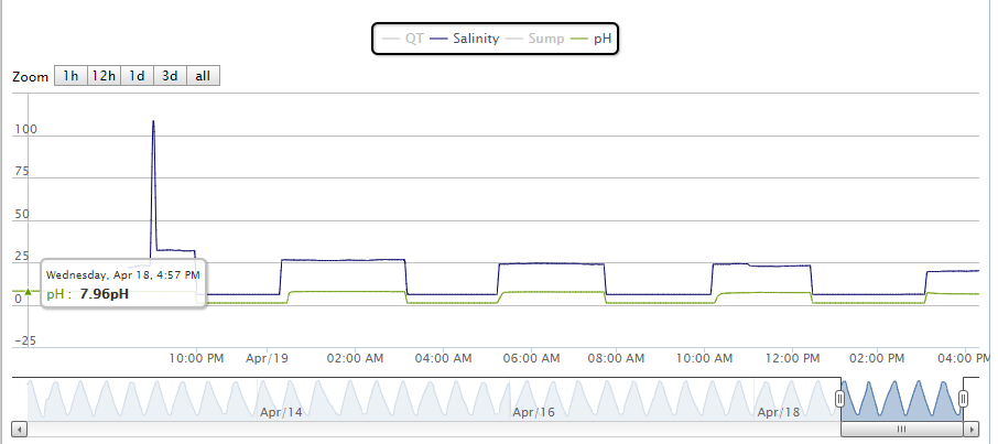

I added relay expansion, power control expansion, and salinity expansion. Having 2 issues 1) salinity probe calibration stability and 2) both the salinity probe and ph probe seem to be oscillating between on/off same period, same length of time...Trying to figure out #2 before sorting out #1. If you look at web chart it's really obvious. File is attached.

have you tried isolating the expansion modules? like just add 1 at a time and check how it does. so remove the extras and just put the salinity probe in and see if everything still oscillates the same.

A new pattern has emerged, salinity still oscillating, but pH is now off (reading 1). I disconnected all the expansions, but pH is still not working.
