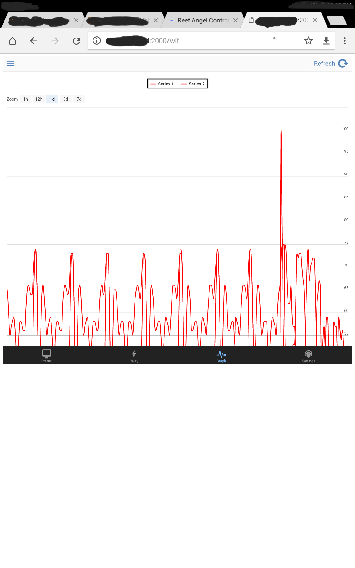

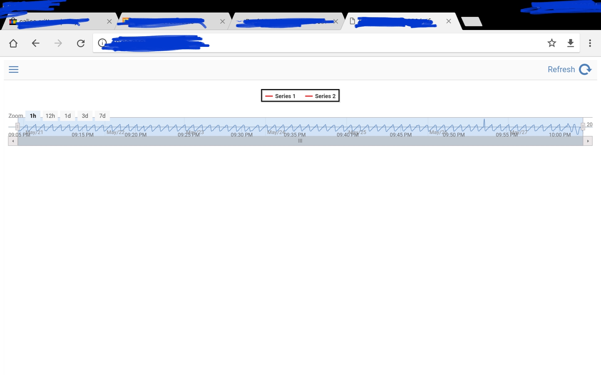

If I go to the U app web base on a Android device if I go into draw graphs I do not get to see the full graph if I do at least custom for pwme4,pwme5 it only shows me a portion of the screen graph I think maybe there's a browser display size issue or something I don't know
One pic is landscape other is portrait orientation

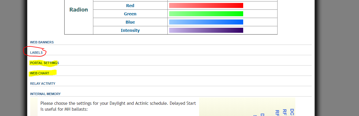

Whenever I click on the labels or Portal settings it just clicks me to the top of the page .rimai wrote:Just to change the labels, you don't need to get port forwarding setup.
Why do you want to get the portal connected to your controller with port forwarding?
I don't seem to have any option to click on any of the options . When I click on it it brings me up to show the top of the page like where the user control panel is and says an error occurred .The way to adjust is to just click on the area I have circled right?
Can you delete the portal info for my acct and let me start from scratch?
Can I literally start a new username and just go from there?
I tried it on two seperate computers just now and still same.
Also Google is saying the time cert for the website is unsafe or something ? My phone did it earlier and now both my laptops I had to bypass and proceed anyway .
- Portal setting.PNG (32.31 KiB) Viewed 45259 times
Re: Universal App
I made a change to the portal page.
Try again.
You may need to reload the page by holding shift while clicking the refresh icon.
I also fixed the issue with the certificate expired.
Try again.

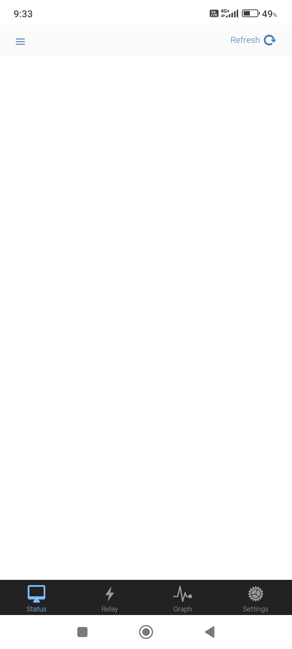

Could you check new version of app please. When I install app it gives me screen as on picture. All buttons are non responsive.
