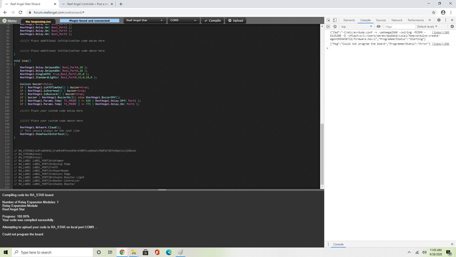

This line here seems strange to me, especially the red section....
(index):505 {"Cmd":"-C/etc/avrdude.conf -v -patmega2560 -cwiring -PCOM9 -b115200 -D -Uflash:w:C:/Users/derek/AppData/Local/Temp/arduino-create-agent600138870/firmware.hex:i","ProgrammerStatus":"Starting"}
It is supposed to point to a avrdude.conf file that resides in your local user folder, like this:
{"Cmd":"-CC:/Users/Owner/.arduino-create/arduino/avrdude/6.3.0-arduino9/etc/avrdude.conf -v -patmega2560 -cwiring -PCOM27 -b115200 -D -Uflash:w:C:/Users/Owner/AppData/Local/Temp/arduino-create-agent547516662/firmware.hex:i","ProgrammerStatus":"Starting"}
I am not sure why it is pointing to a UNIX like path.
Let's try this....
Go to folder C:/Users/derek and make sure you can see hidden folders.
Delete the folder .arduino-create
This should force the plugin to download that folder again, which contains the avrdude.conf file. Let's see if this works.

I deleted al of them, as there were several. Im assuming from the many many attempts last night after adjusting things. Same thing. NO reboot of the head.
HEres a screenshot of console.
second console.png (374.94 KiB) Viewed 15991 times

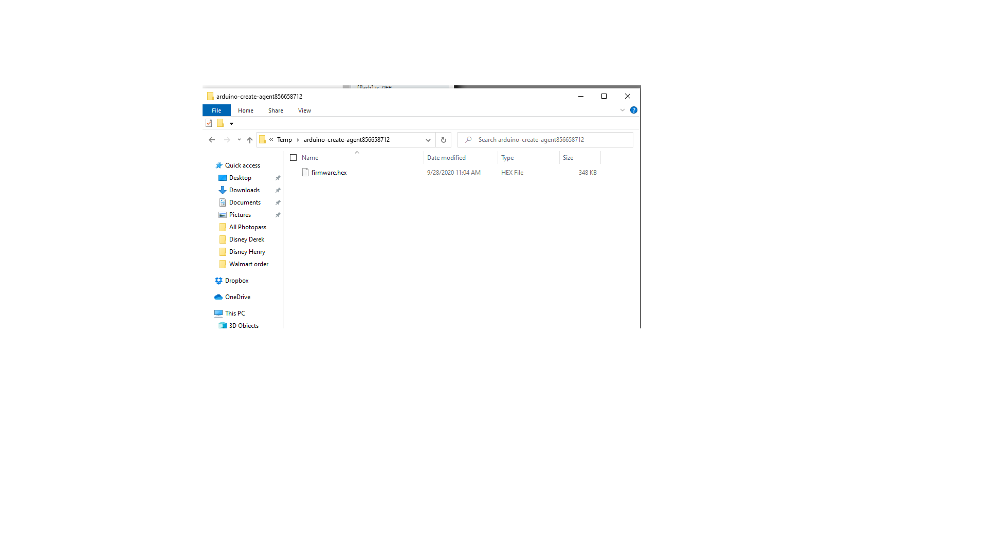

the only file that gets created is firmware.hex
I have full rights to this directory, so im not sure why its not creating the conf file.

not sure if this helps, but the folder it creates in app data, when you try to push code, creates a zipped folder called tooldownloaded if i extract it, theres a ton of stuff in there. I was poking again before i logged back in for work.
Re: Com 3 only option and i get Can not program Board in Wiz
Posted: Mon Sep 28, 2020 12:13 pm
by SouthernReefer
Looking again at the contents of the folder, i see no where on the machine where avrdude.conf is present. Almost like it doesnt get downloaded when i Install the plugin?
Posted: Mon Sep 28, 2020 2:32 pm
Yes, it did help.
Thanks for helping troubleshoot this.
I found the problem. Please reload the webwizard page and let me know if it works now.
