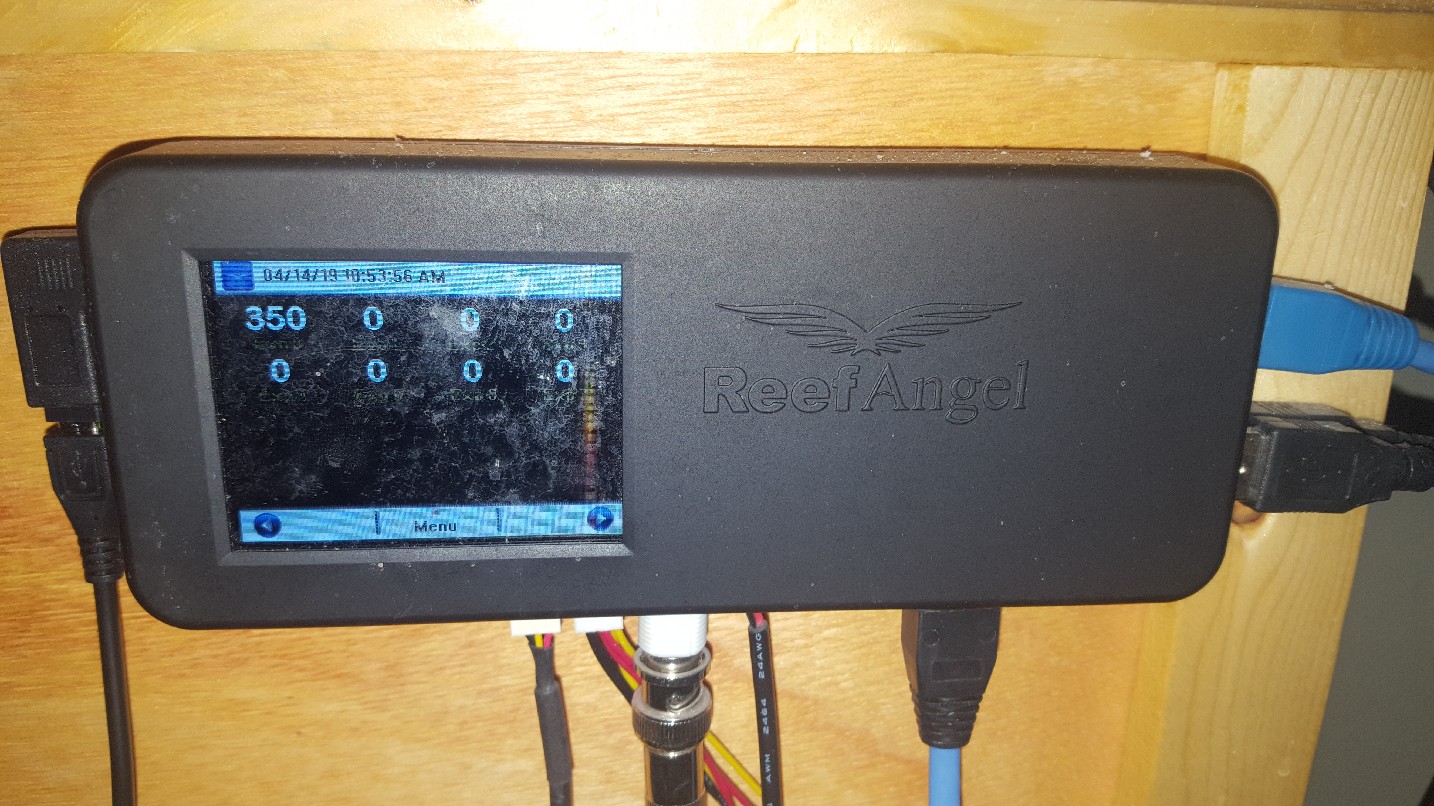

The lights were on dim this morning, unfortunately I didn't have the Cloud hub connected to a computer. The 16ch lights didn't come back on with the power off/on.
That said, I think there's progress with the Salinity probe.
A note here: I found have to make sure I do a certain sequence. If I do anything that resets the Cloud Hub, I have to power cycle the RA* for things to connect and show correctly.
Once I connected the Cloud Hub to the laptop, the values for the Salinity probe connected to it began showing up on the RA* screen and the UAPP. The value replaced the Salinity probe in the DT though; both displayed ~208.0 under 'Sal.'
I couldn't quite follow your code so didn't know if that's what you wanted it to do but I thought that since it was displaying I'd try to calibrate it so I tried calibrating Custom Expansion 1 and that did nothing (probably not supposed to).
I then tried the normal Salinity calibration and that worked as it was supposed to.
To get my DT Salinity re-displayed, I removed power from the Hub's connected Salinity module, power cycled the RA*, and re-calibrated to the DT's Salinity probe.
Serial log for the above (I put a series of dashes in the text file to highlight the Calibration events):
