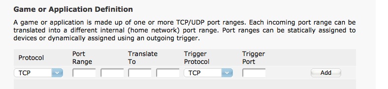

Can someone help me set up my port forwarding - it does not seem straightforward!
My router wants me to enter the info in the pic attached - what should I enter?

You should have an area for Port Range Forwarding(which you posted above) and a section for just a single Port Forward. In this scenario we really dont need a range of ports but just a single port(2000).
Protocol you can set to TCP; Port would be 2000; Then the 3rd field would be to what internal address you are wanting this forwarded too. Ex. 192.168.1.105

Hi, definitely the pic is the only area that I can assign port forwarding there is no other area?

dazza1304 wrote:Also, just to confirm, am I be able to update from 3G rather than wireless or is it only possible with wireless?
If you are talking about updating the parameters on your iphone app, then yes, you can do it over 3G, but requires you to setup port forwarding.
On your router, you can still use that page with the ranges and shoyuld work fine too, I think.
Yuo can use
Port Range: 2000 - 2000
Translate to: 2000 - 2000
Trigger Port: 2000
Then go to http://www.yougetsignal.com/tools/open-ports/ to check if you have an open port 2000.
If it says open, you are good to go.

Tried the above, but says port is closed?? :cry:
Any other thoughts?
