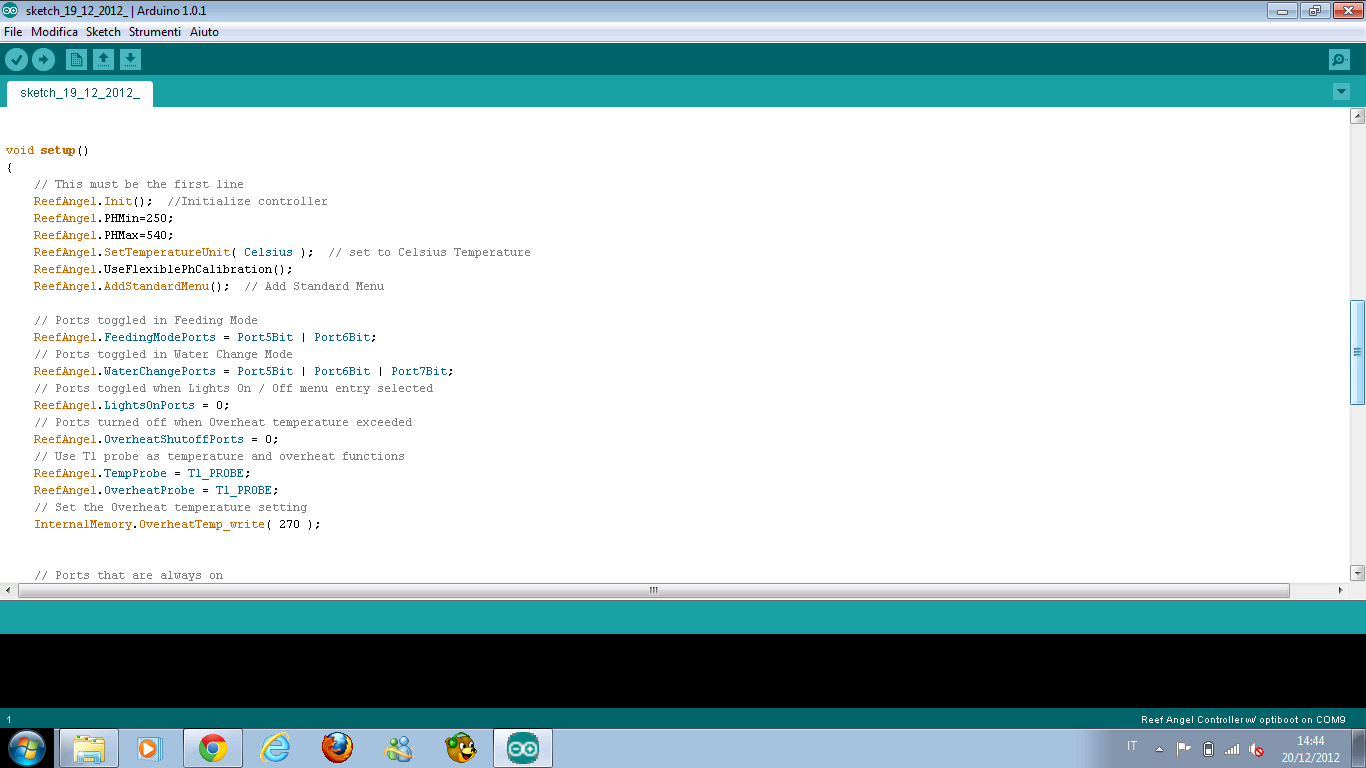

i have add this
wharis problem?
wharis problem?
problem ph.png (61.18 KiB) Viewed 12836 times
Re: problem ph
Go though the calibration now.
It will let you pick which numbers you want to use for calibration.
Use the joystick to move to the ph number and then select which one you want.

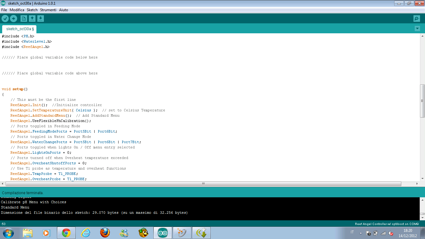

Where should I put these two lines?
ReefAngel.PH Min = 250;
ReefAngel.PHMax = 512?
marco3020
Posts: 75
Joined: Sun Feb 19, 2012 12:18 pm
Re: problem ph
Post by marco3020 »
good this?
ph min and max.png (55.16 KiB) Viewed 10965 times
Re: problem ph
You don't need those lines.
Just go through calibration and make sure you pick ph4 and ph7 as reference or it won't work.
