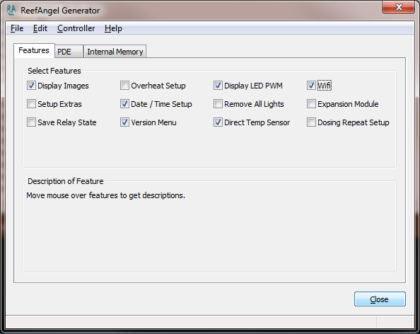

Posted: Fri Aug 19, 2011 7:59 pm
I think you just found a bug :)
To overcome this, just make sure not to use the "Save Relay State" on the Features tab.
Then just generate the code again.

It still shows this error. What I did.
1. Opened REGen
2. Used defaults in "Features" and add WiFi

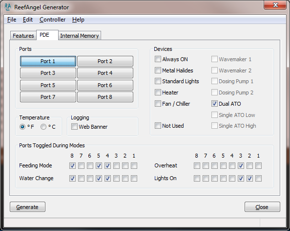

3. Used defaults in "PDE"

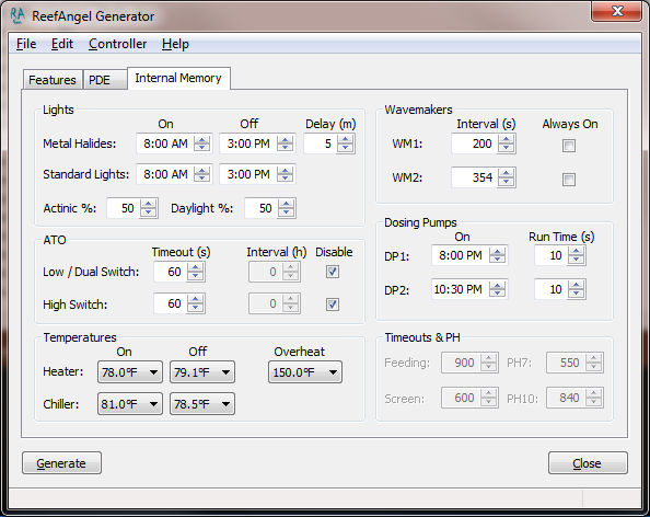

4. Used defualts in "Internal Memory"
5. Switched back to "PDE" and clicked Generate
6. Opened PDE file in Arduino (Reef Angel Controller)

Tried with "Save Relay State" selected with same result :(
