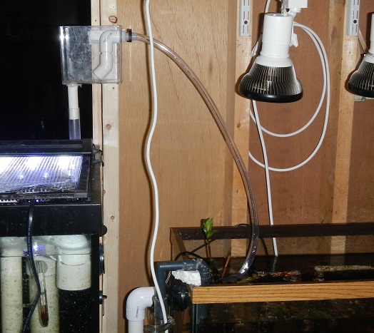

So got it all built and coded. And it works well, I ended up running it for 4 seconds and I may be reducing that to 3, still on the fence about it as if the food has defrosted a bit 4 seconds tosses a bit of it out of the dish.
Here's the whole setup. I used a cheap hang on acclimation container and drilled two holes in it and put the small pump in the frag tank next to my DT.

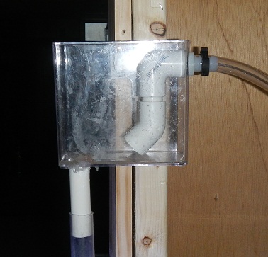

Close up of the container.
Re: Turning a port on for 1 minute, twice a day.
Nice :)
