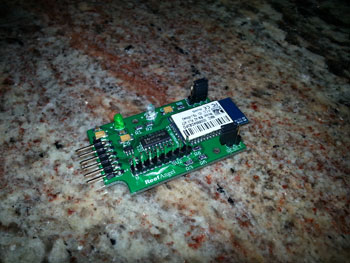

Hi Guys,
I have a few boards that you can purchase in advance before they become available in the webstore. This module is used for wireless code upload and you won't need to keep connecting usb cable and disconnecting the wifi attachment from the head unit.
It is connected directly to the head unit and the wifi attachment is daisy chained to it.
Data traffic is routed to wifi or Bluetooth on-demad as needed.
They are going for $89.
PM me if you are interested in grabbing one of them.
This is installation instruction until I put together the manual.
Note: You will need your own Bluetooth adapter properly installed in your computer.
Connecting the Bluetooth attachment
1. The Bluetooth attachment comes with the communication cable. Please connect the 8-pin connector to your Reef Angel head unit and the 6-pin connector to your Bluetooth attachment. Pin 1 is the black wire.
2. If you also have the wifi attachment, you can connect the 8-pin connector from the wifi attachment to your Bluetooth attachment. Pin 1 is the black wire.
3. Please confirm that you can access your Reef Angel system through wifi.

Ok, so until I put together the manual for the module, please refer to the original post.
Re: Bluetooth Attachment
Got it set up and working.
A coupe of small things.
1 time said that the port was already in use.
I shut down the Arduino software and restarted it and it was fine.
The 2 was that in the middle of uploading the Arduino software just closed.
Opened it again and it worked fine.
Great work Roberto.
So after a horrible day fighting with it and my computer (mostly my computer) I got it going. I went and found the replacement for the rxtxSerial file and it seems to have solved my problems.
Roberto, what does the on/off jumper do?
Awesome!!!
The on/off jumper is meant for turning the programming mode on/off. Mainly for me to program any settings it needs to be pre-programmed before shipment.
I found and replaced the rxtxSerial file too and it seems to be working a lot better
The tools menu opened up right away and not problems uploading this time.
I tried to upload after my last post and I got the message that Com port 4 was being used 2 times before it uploaded.
When I tried uploading after replacing the rxtxSerial file it went smooth.
Default should be off? When I have it set to off my head unit screen goes black and the status light comes on.rimai wrote:Awesome!!!
Make any sense?
