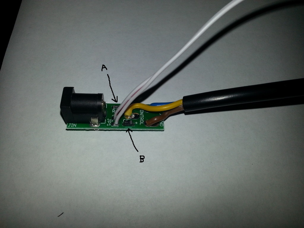

btw, i think i got normal jebao cable,
roberto, can you more details for this?
rimai wrote:Only one ATO port can do PWM.
pinMode(lowATOPin,OUTPUT);
analogWrite(lowATOPin,ReefCrestMode(60,20,true)*2.55);
The cable is designed to work on 0-10VDC signals.
You will need to mod the cable if you want to use 0-5VDC signal.
Take one resistor and bridge the pads instead.
do i need to open jebao cable and do something?
any pics to do this?
Re: add jebao wp25?
I actually updated that post...
There is no need for pads to be bridged. Only R2 needs to be removed.
http://forum.reefangel.com/viewtopic.php?p=24152#p24152

Post by kimacom »
so, remove A or B?
just take it out?
no need other connection after take out?
sorry for noobies question.
jebao cable.jpg (177.37 KiB) Viewed 5881 times
Re: add jebao wp25?
It should also say R2 printed on the board.
I can see that A says R, but the PWM wire is blocking if it is R1 or R2, but B looks like the position of R2 according to Roberto's schematic, but I think I see a C1 there which would be the capacitor.

Re: add jebao wp25?
Post by kimacom »
haha, thanks steve
so you are not sure which is A or B,
maybe something behind yellow line could be B, i think
i will check when get at home!
Re: add jebao wp25?
I can't tell from the photo you uploaded. If you can get a shot from above I could probably see the printing on the PCB, but my point is that it should say R2 on the board somewhere. That will be the resistor you need to remove.

Post by kimacom »
I found R2. It's right next R1 seeing on the pic.
I didn't connect yet but remove R2 is easy.
Now I need to make code and update it and hook it up. Wish me luck :)
