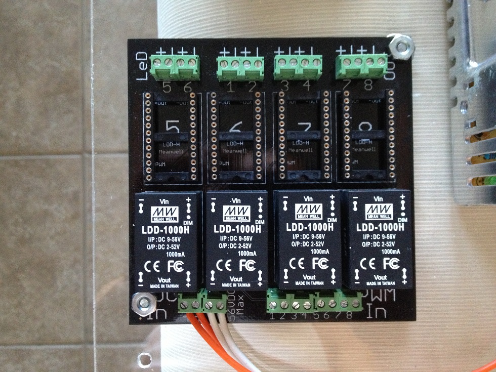

So got my RA+ in and trying to install my dimming module to a ldd driver board. I know on the dimming modules, the first 6 slots is for channels 0-5 and the last 3 slots are for the ground. Looking at the board i got, the top green slots are for LED output, bottom left is vdc input and bottom right 8 slots are for PWM in. But there isn't one for ground to the dimming module? does the dimming module need a ground?

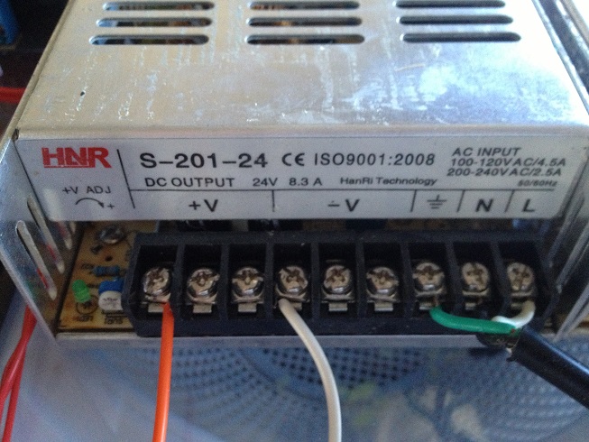

Yes, should be the same as the GND of your power supply.
I think it is the white one in your photo. I can't see the marking underneath it.

Re: Dimming module install question
I guess you are referring to the -V in the picture below when you say ground and not the actual ground coming from the VAC next to the neutral and live.
I am using 2 power supplies, should each one have a -V going to the ground on the dimming module?
Yes, the V- of your power supply.
Just one is enough, because they are already connected together in your LDD board.
