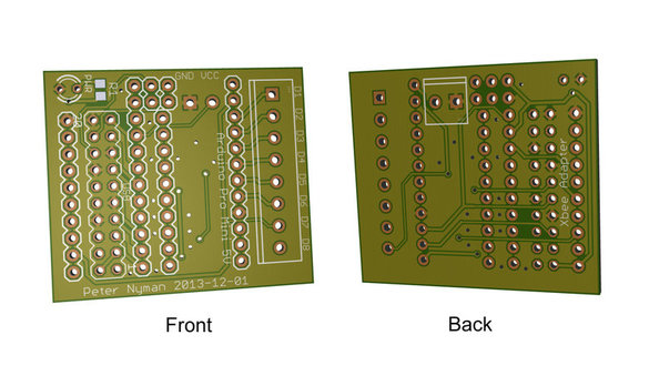

The making of a relay box is a non-issue... I've going to send the board below to a manufacturer... It's a tiny board with a Arduino Pro mini ($3 microcontroller), space for a xbee adapter board (on the backside) and two USB connectors. making it look like an RA expansion with the standard i2c-interface (instead of the bulky HDDB15 cable), but also with the option to interface it wireless using xbee protocol... It is powered by a very small AC/DC board and controls carefully chosen relays (with low input current requirements). All boards are so tiny they will fit the standard power bars I'm using.

Don't forget the snubber diode
I don't see one in there.
When turning relays, you want to have a diode to consume the feedback voltage of the coils when they open.
Re: Open source hardware discussion?

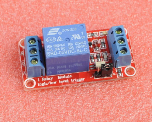

Thanks, but the relays is complete boards, with the extra components for the relay, including optocouplers... Each input only requires 5 mA trigger current, so I guess I can just connect the Arduino outputs directly to the relay boards.rimai wrote:Don't forget the snubber diode

Yes, thats a neat and simple solution... I actually considered that first, and it still is my backup plan, but my solution has a number of advantages (at the cost of just a little more complexity), (if I manage to implement them!):
1, Can be extended with xbee wireless control
2, Can be extended with another extension that plugs in to this unit... Very neat if combined with xbee. (The unit has to USB plugs: 1, In from main unit, 2, Out to extension)
3, Can be made to operate in stand alone mode with configurable default states on the plugs (even after power off/on cycle). This means the unit does not turn off all outputs if I need to unplug the main unit for some reason.

If you look at the libraries closely, you will find that I have already implemented this in the libraries, so you can take advantage of that too. I called it RANet
https://github.com/reefangel/Libraries/ ... l.cpp#L459
The receiver is pretty much what you have, except it is in a different form factor, so it is a little bigger, and it's got a few more components for status indication and voltage translation.
I just sent the latest revision of the receiver to the board house a few days ago.
The RANet payload will have status of all relay boxes and their respective fallback state, as well as status of the dimming module.
Eventually, I plan on appending the payload with all the parameters too and possibly have a wireless remote screen, if I ever find a decent screen to use. Who knows
