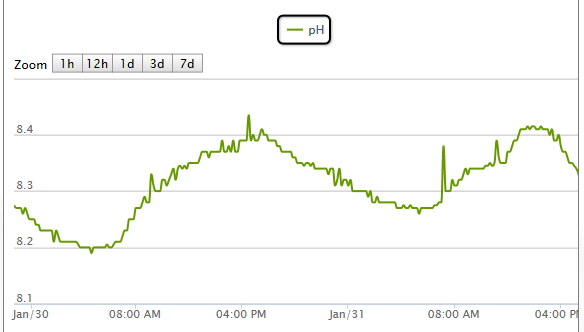

Looking at your chart, it does look like you get the variation from day/night, which is good.
A few days ago, your chart showed numbers in the 8.4 range with a beautiful sinusoidal waveform. What did you do to bring it down or change it? I think the calibration didn't go too well though.
809 looks to be in the lower end, which could explain why your numbers are low.

I dosed the hell out of the tank with 2 part assuming the probe the was correct back checked after 2 days only too find my dkh around 14
