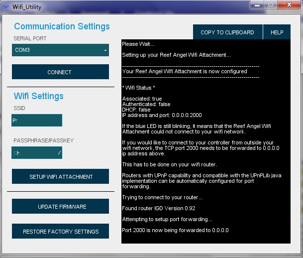

After finally getting my reef angel, finally finding the Wifi utility (Thanks for the help in that - you know who you are.), I cannot get my wifi going. I run the utility and it gives me this:
What the? Even I know that 0.0.0.0...... isn't going to do anything.
Any help would be greatly appreciated.
GC
GC

Try changing your router to WPA2-PSK with AES encryption instead of any other or mixed.

WPA2 Personal, AES encryption. No Change in result. What else you want me to try?
