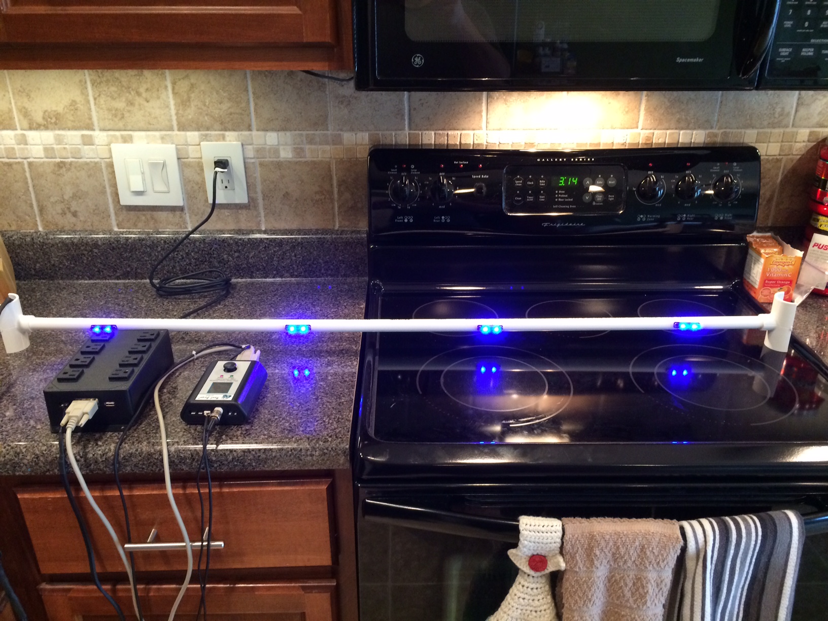

It's official, I'm a Reef Angel user!!! I had to go buy a new wireless router, but I'd been putting that off for years. I'm embarrassed to say it was one of the first Cisco Valet models (2006?) so it was WAY past time. Once I got the new router, the wireless module works like designed. Kudos on all the documentation and screenshots. Precisely why I switched to RA, because everything from the equip to the documentation to the website is built by people who build custom things would want it done! OK, so new questions...
1. I have 4 lunar pods from my Reefkeeper. I know the RK module isn't compatible, but how can I wire all 4 to use a single (actinic or daylight) port? Would that decrease the wattage? Trying to avoid buying the $149 lunar expansion if I can. Could the RK module RJ-11 plug be modified to use only the red/black wire pair?
2. If I buy the Salinity expansion will my RK salinity probe work? It looks identical.
3. What is the best way to program my 3 Kessils, note they are 350Ws so there is not interface cable. I'm really just trying to program an on/off cycle. Right now all three are plugged into a power strip which plugs into the controller. I'd love to have some sort of ramp on them, if its possible.
Thanks in advance for the responses!
I'm really excited to get this thing going.
Randy

Re: Fed up with DA/APEX - Ready to DIY
The lunar hub is $59.
Roberto says the moonlights are pretty bright so you may be able to get away with the 2 included.
1) I doubt all 4 of your moonlights can run off one dimming port. I think it would draw too much current. If you can figure out what kind of voltage they are using, you might be able to just wire them to a power adapter and put them on one of the relays. You would loose dimming capability, but you'd have moonlights. Alternately, you could buy some blue LED strips from Ebay or Amazon and do the same thing.
2) I think so, maybe someone else can chime in. The salinity expansion also comes with a probe so you'd have a backup.
3) You could put them on different ports and turn them on/off at different times. If it were me, I'd do the middle one first and then turn the other two on later, and the opposite at the end of the light cycle. Maybe the middle one on one outlet and the other two on another.
I ended up just selling my my RKL as a package. It may be worth more to you that way instead of trying to make pieces work with your new setup.

I believe you can only run one of the moonlights off a dimming port.

It's official - I'm able to run all four (4) ReefKeeper lunar pods (8 LEDs total) off a single RA dimming port. I just connected/soldered all the + and all the - leads and then spliced into a single harness for the dimming port. I, too, was afraid that there wouldn't be sufficient juice to power them all, but apparently there's plenty. I run them at 50% and they're still plenty bright. I'll post a pic shortly.

You might check with a meter to see how much current that's pulling.

Pic showing 4 lunar pods merged into a single dimming port.
