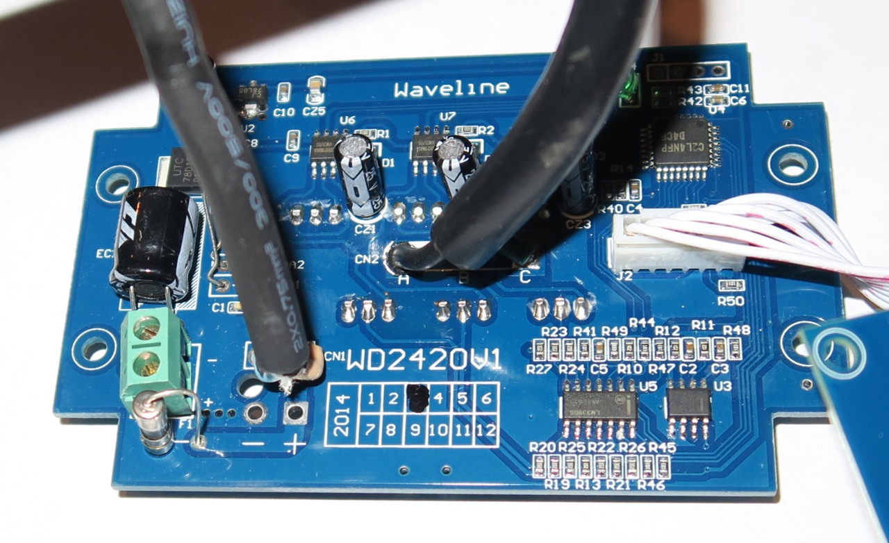

After modifying the Jebao control cable to accommodate the 0-5v PWM signal coming from the ATO pins on the controller, I noticed that the Jebao cable and the Waveline DC10000 II pump that I wanted to control has the wrong cable terminator -- unlike the Jebao pumps which have the female terminator coming off the pump, the Waveline has a male terminator coming off the pump, which you can't connect to the Jebao control cable (since it, too, has a male terminator).
Searching the forum, I see that this has come up before, and someone even tried cutting the cable off of the Waveline controller to wire it to the control board, with no luck.
Would it be helpful to measure the output from the Waveline control box with a multimeter (I may be able to find someone at work with an oscilloscope, if needed) to determine if it's just a simple pin remapping? I'd really like to have dimming control of this Waveline, and it's not easily replaceable in my setup.
Re: Waveline control with Jebao harness
Open their controller box and send us a photo. Front and back of the board.

That took some doing. They really box it up good.

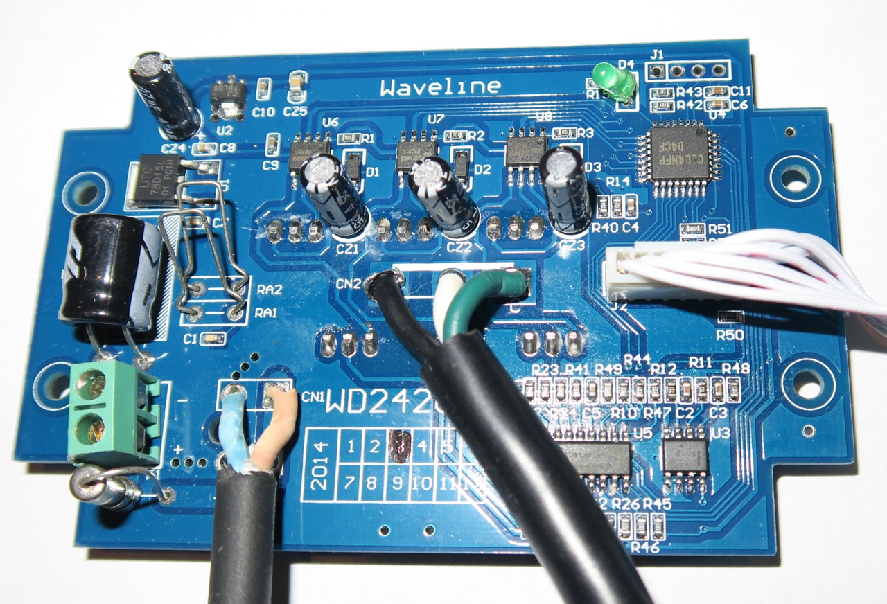

Under the cables:

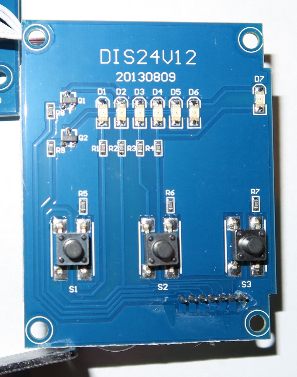

Breakout board for lights and buttons:

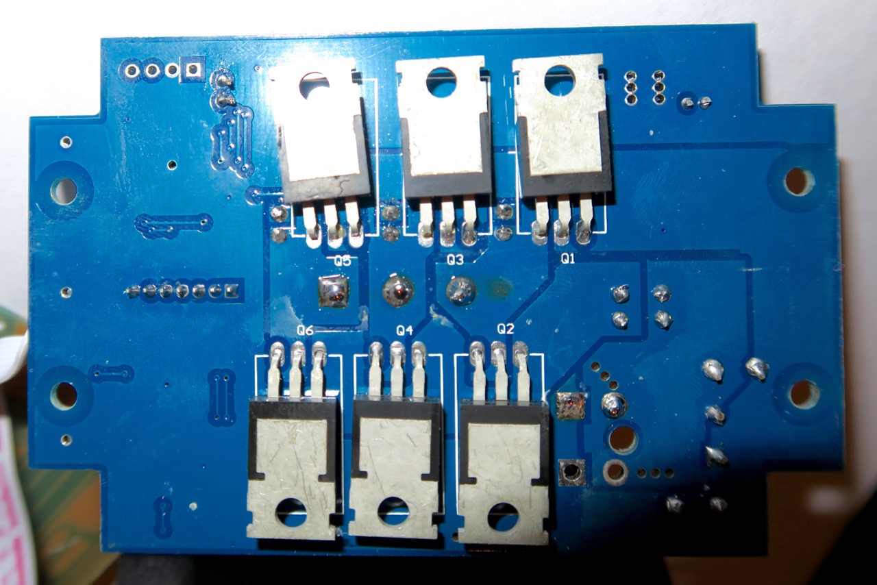

Backside of main board:
(Breakout board has no backside -- one layer only)
I think this can't be used either :(
Looks the same as the new Jebao and the Gyre.
The driver is in the control box and not inside the pump as the old Jebao pumps :(

Any way to tap into the board (i.e., connect the dimming pins from the Reef Angel dimmer to some device inside the Waveline control enclosure)?
