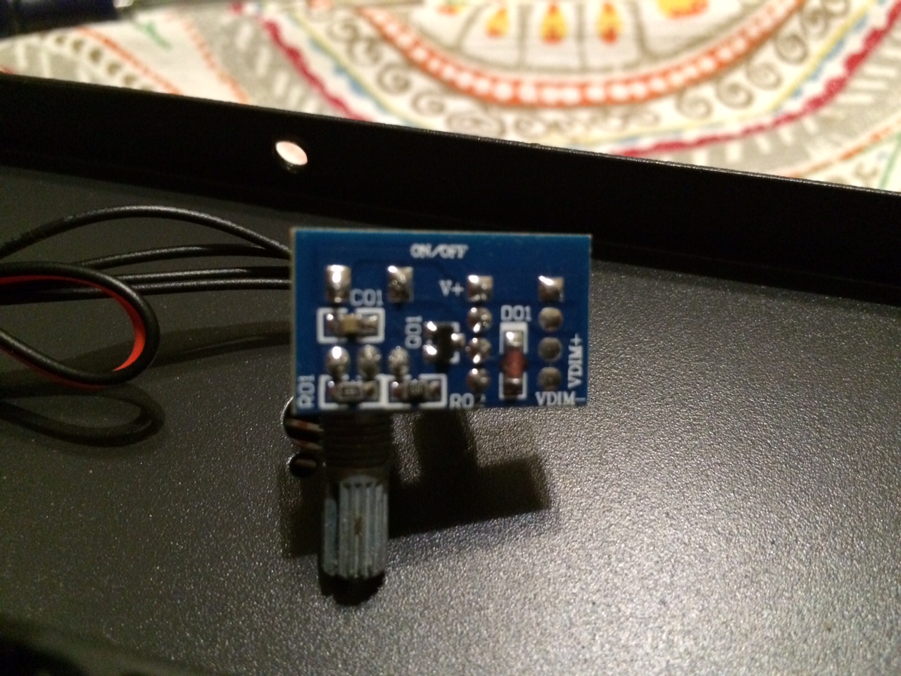

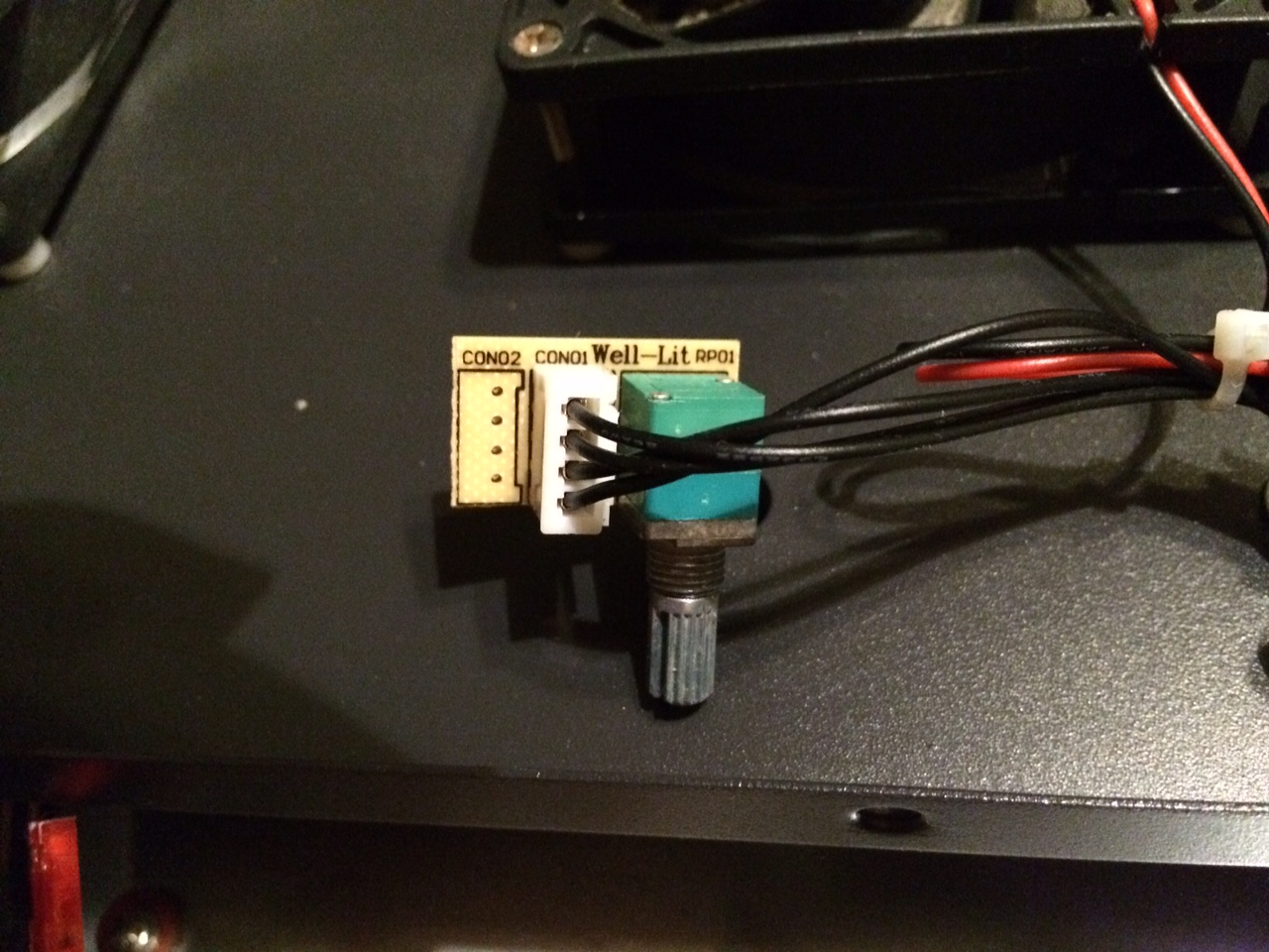

I bought a RA PWM with the intention of hacking my LEDs to work with them. While it finds it's way to me I wanted to start the planning. They're the standard Chinese LEDs. This picture is from a Euphotica 16". I also have a Aquamana that I haven't cracked open yet.
Is the procedure the same for all of them? Use pins 3/4 and bridge 1/2. Is there a way to tell from looking at the pot board if they're PWM or Analog?
Picture of my Euphotica
LED Bottom.JPG (413.45 KiB) Viewed 11866 times
LED Top.JPG (363.39 KiB) Viewed 11866 times

They are usually 0-10v analog.

Well I guess I can use the PWM for my Jebaos... Ok, so I'll add a dimming extension board to my list of "to buys".

I took a stab at it tonight. It's working perfectly with the dimming expansion module jumpered to 10V analog. Thanks Lee!

Jeabo can be controlled analog or PWM.
You need to see what your lights take, probably analog.
The domming expansion module has jumpers in it to set it for analog of PWM, as well as 0-5 or 0-10 volts.
